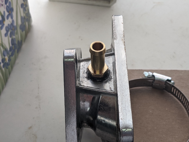

Hi Rich,
This is my solution. I have applied it to my Dart and my D100 and it seems to be working.
I added a port into the 2 into 1 carby adapter so as to not affect any one cylinder with the PCV shenanigans.
This was based on a thread from SlantSixDan.

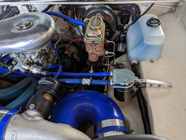

I then added a catch can to try and filter some of the PCV gunk and a check valve to keep the boost from sending the catch can contents back towards the PCV valve.
Its homegrown , but I did take auto shop in high school.

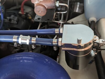

Interesting. So the line closer to the bottom of the pic goes to the PCV and the line closer to top of pic goes to the carb adapter, correct?

Hi Rich,
Actually, the lower/ closer hose comes from the OUT port of the catch can and goes through the check valve to the carby adapter which is manifold pressure. The arrow at the top of the check valve shows that it will allow the gases to flow to the carby adapter when there is vacuum, but inhibits flow to the catch can when there is boost. The upper/ farther hose comes directly from the PCV valve to the IN port of the catch can.
