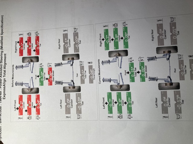

Took the 68B to a local alignment shop today to get a professional job done. Grilliot Alignment was highly recommended by every local car enthusiast that I spoke with.
I will put a posting up in the social corner of some of the cars on the premises.
The pre and post alignment values are in the photo below. Click on the photo and it should go to a portrait orientation.
The shop has an experienced tech that does all of the classic cars. A good guy we talked a lot prior to starting the alignment. I had been fine tuning the ride height the past few weeks and he re measured and made a slight adjustment with the car setting on the level alignment rack.
Before Measurements
I set these results a few years ago working in my home garage. To set the Caster, I basically took each UCA eccentric on each end of each side in opposite directions, then backed it off a bit to restore some Camber.
I then readjusted the eccentrics to even out the Camber side to side. The UCA have the Mood Problem solver bushings. Using string, a few levels and angle finders I had the front end relatively balanced side to side.
After Measurements
Using the Skosh Chart as a guide I has the alignment shop target the Max.Perf.Street section, with an emphasis on equalizing the Left and Right sides.
Looks like they got it.

Looks like perfect specs to me. Essentially the same as what I put into my street cars that are good for cornering.

And loosen the torsion bars, remove the steering arms from the lower ball joint slide some ~1/8" to 3/16" washers under the steering arm / ball joint junction... re-assemble and now your set for track day & auto x.

What does an 1/8" washer do on the steering arm? :?:
PostPosted: Wed Aug 28, 2024 5:59 pm
Posts: 10398
Adds negative camber when placed between ball joint and spindle or lower steering arm and spindle.

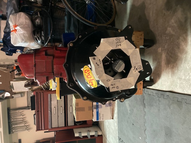

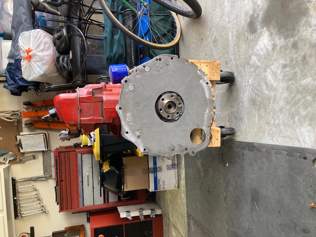

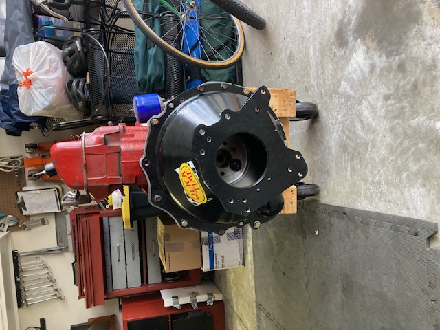

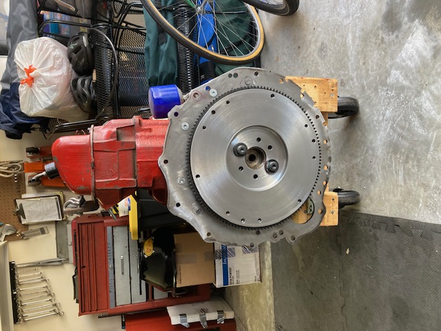

The 68 Barracuda has an A&A built 904 transmission, and that was fine when its primary use was drag racing, however now that it is a rowdy street driver I am starting the process to install an A body aluminum case a833 OD transmission. Using an adapter plate that I believe is a copy of a piece made by Team Green. I have had this plate for a long-long time so its origin is a bit hazy.
The good news, it fits fine, using straight dowels on the block and the SBM QT housing it indexed in really close to good. This is a long term 'spare time' project. Looking to get-it-done mid to late 2025.
When I rebuilt the car years ago I put in the 4 speed hump and pedals, so that bit is done. I am sure that I will be using some brand of hydraulic clutch.
I need to figure out which hydraulic clutch, which shifter assembly and rods and the actual clutch disk and pressure plate to use.
I am sure that I will have questions.
On a related note, I contacted Brewers to inquire about going through the A body a833 that I have and was told they are not accepting any new transmission rebuild work until they catch up on what they have already on hand. And they say they have a years' worth of rebuilds already to go through.
