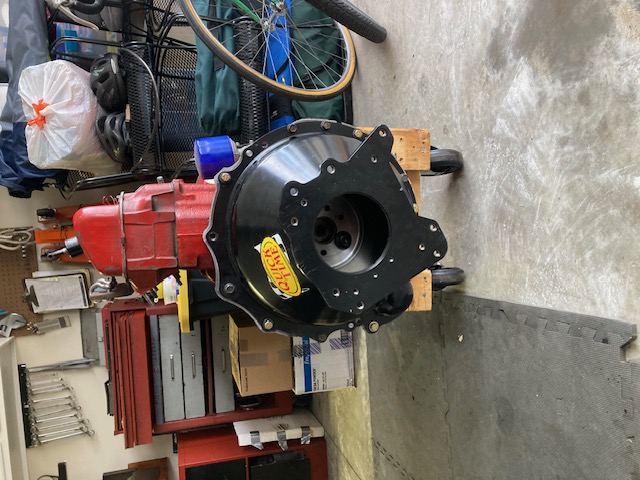

The 68 Barracuda has an A&A built 904 transmission, and that was fine when its primary use was drag racing, however now that it is a rowdy street driver I am starting the process to install an A body aluminum case a833 OD transmission. Using an adapter plate that I believe is a copy of a piece made by Team Green. I have had this plate for a long-long time so its origin is a bit hazy.
The good news, it fits fine, using straight dowels on the block and the SBM QT housing it indexed in really close to good. This is a long term 'spare time' project. Looking to get-it-done mid to late 2025.
When I rebuilt the car years ago I put in the 4 speed hump and pedals, so that bit is done. I am sure that I will be using some brand of hydraulic clutch.
I need to figure out which hydraulic clutch, which shifter assembly and rods and the actual clutch disk and pressure plate to use.
I am sure that I will have questions.
On a related note, I contacted Brewers to inquire about going through the A body a833 that I have and was told they are not accepting any new transmission rebuild work until they catch up on what they have already on hand. And they say they have a years' worth of rebuilds already to go through.
