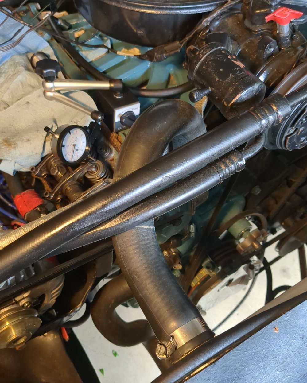

I obtained a dial indicator and then experimented with ways to find actual TDC and to measure cam movement with as little disassembly as possible. I'm optimistic that I finally have this cam degreeing thing understood at an apprentice level, or at least it isn't the occult ritual I perceived it to be just a few weeks ago. I'm looking for some confirmation from you guys to make sure I understand properly the information I now have before I plow forward and pull apart the front of the engine to make the adjustment I think I need to make. I've attached pictures so you can see yourself the results of verifying my intake cam lobe position. To explain, here's what's in the pictures:

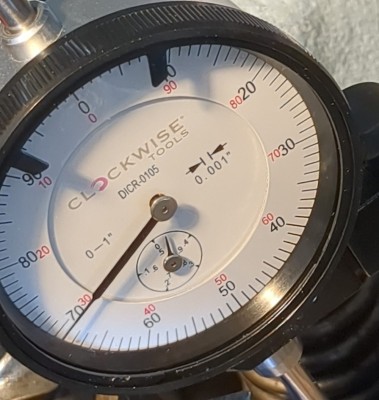

Dial indicator reading the intake cam opening at .020. From all my research (my Haynes manual, info I've read on this forum, etc), the stock rocker arm ratio is 1.5 and the ONLY place I could get a reliable reading without taking apart the rocker assembly is on the retainer. So, the indicated .030 opening reflects .020 x 1.5.

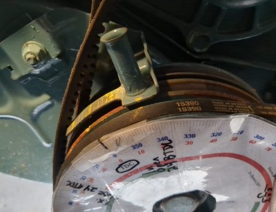

My actual TDC was found to be dead-on and the "pointer" is the yellow mark on my factory probe tube. With that being said, I turned the engine clockwise until I achieve the valve opening of .030 and my effective crank measurement is 16 degrees BTDC. I perceive this is my issue, since the cam card indicates it should be 24 degrees BTDC. This suggests to me, if I'm not mistaken, that I'm likely off a tooth on my cam gear.

Did you remove all the valve lash before starting? No your rockers are not exactly 1.5. They could be 1.45 or 1.55 or somewhere in between.
I do my measurement off the Intake Centerline number on your cam card. Yours is 106 degrees. Once you are sure the TDC mark is correct. Make a temporary pointer to point to TDC on your paper wheel. Rotate the crank until the camshaft reaches the highest lift on the intake valve retainer. Turn the dial indicator to zero. Then go to .020 or .030 on either side of that zero and write down those two readings.(It doesn't matter what number you measure at as long as you do the same before and after the peak) Add them up and divide by two and that is your installed intake centerline. Double check your work. If it turns out to be 100 then you are 6 degrees advance and if it is 110 you are 4 degrees retarded. Adjust accordingly. Honestly if you are withing 1 or even 2 degrees of where you want to be, you are probably fine.

I did measurements on intake centerline and found that I am off by four degrees. I measured twice and I'm consistently coming out to 110 degrees. That seems to confirm my measurements on intake timing, suggesting I'm off a tooth. It looks like it's time to grab my favorite barley pop and get the wrenches out and adjust my chain.
PostPosted: Sun Sep 29, 2024 11:25 am
Posts: 9500
I think one tooth will be a lot more than 4 degrees. You will need to drill the gear and use offset bushings.
