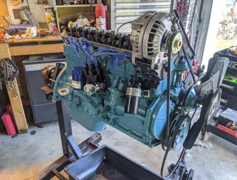

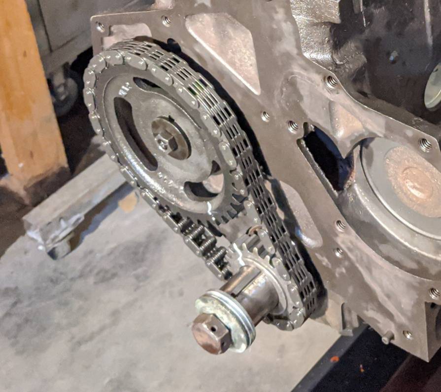

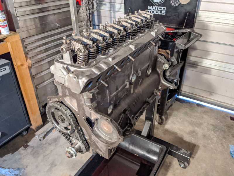

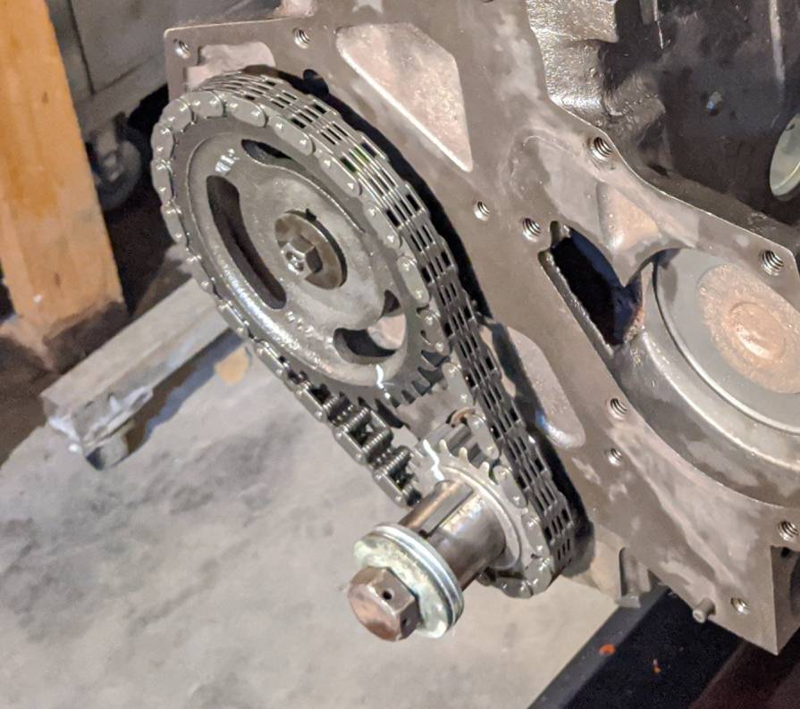

I'm attaching pictures from LAST YEAR, after we had ultimately found ourselves guessing on cam timing. You can see our marks on the sprockets.

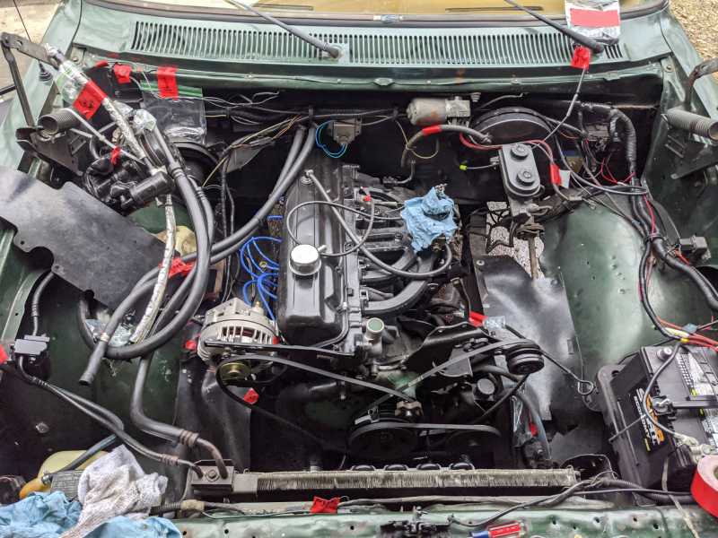

I've also posted a picture of the engine bay, with the engine installed BEFORE we pulled it and overhauled it. It looks nice and painted, but it was worn to pieces inside..

I'm now confident that my cam timing is off a tooth.
You just can't move it a tooth. It may be off just as bad the other direction. Your going to have to figure out how to degree it if you want it in right. Before you pull the damper and everything off, mount your degree wheel again and check where it is at before you pull it apart. We'll help you! :D

Rick's right. And in complete sympathy with your difficulties, I quote John Jerome: "You can't get the cam timing right until the cam timing's right". That's from Truck, his excellent 1977 book (also available to read for free on the Internet Archive here and here).
Yes, you can change the cam timing without dropping the oil pan. You'll have to pull the timing cover, and you'll still have a fight with parts of the oil pan gasket—the notoriously-difficult-to-seal "Bermuda Triangle" at the right front corner, its corresponding left front corner, and the rest of the gasket area sealing the bottom of the timing cover to the front of the oil pan.
I see adjustable rocker arms, so I guess you've either built a pre-'80 (solid-lifter) motor for this truck, or you've converted an '81-up (hydro-lifter) engine to solid lifters. That's fine as long as you have all the correct valvetrain parts, including camshaft, not a mashup of some hydro and some solid parts—and if you've converted a hydro-lifter motor, you've taken steps to reduce oil volume to the top end.
Speaking of oil to the top end, that looks like an aftermarket valve cover. Those usually don't have baffles in, which will mean high oil consumption, fouled spark plugs, and pinging. Read up on this and how best to fix it (other than installing a stock valve cover with baffles, which is probably the best/easiest/least costly way) here.

Solid lifter head. Spark plug tubes in the photo. I see no reason to try and reduce oil flow if switching to solid valve train from hydraulic. Actually if the cam is on a earlier blank the oil will be reduced automatically by the different oil metering of the rear cam journal. Solid cam has two intersecting oil holes in the rear cam journal, where the Hydraulic cam has a full groove. But many "new" solid cams are ground on hydraulic blanks and have the groove.
PS: I add a groove to all my slant six cams. Just not as wide or as deep as the factory hydraulic cams.

I might agree with you if not for that valve covr; the combination of excessive top-end oil and a no-baffles valve cover will have too much oil entering the intake tract via the PCV.
Yes; I raised the issue to check if the OP knew/verified all compatible valvetrain parts.

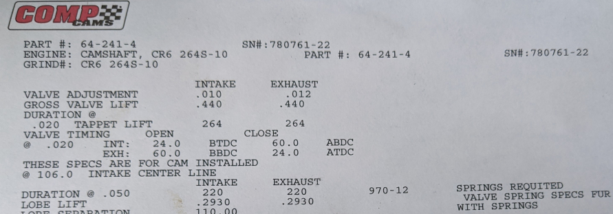

You bring up some valuable questions, none of which I've read about in any of my manuals. I'm glad you brought them up, since I can share my shallow knowledge and learn something!
1) I purchased the truck and it was running, but it was smoking like a BBQ and the inside revealed it had been rebuilt numerous times before. From researching the block, I found it's a very early 225 with 3 frost plugs, spark plug tubes, and a serial number that is before any sort of meaningful numbering scheme. From what I could find out, this means it's probably very early sixties but apparently you can't determine a year on the early ones. So, with that being said, it's solid lifters under there. The cam is a new cam with a mild profile - here is the cam card:

Oof…that Comp cam. I fervently hope you have better luck with it than others have.
For engine info, look for a stamping on the block deck, below the frontmost spark plug—visible with the head installed. If the block has been heavily decked it will have been erased, but if you find a stamping there it'll help figure out what this engine (or at least the block) came from.

What experiences have you heard of regarding this cam? I should probably know what to look out for.

Enough-more-than-one instances of the engine not running satisfactorily/not up to expectations, no matter what was tried. In general I dunk on Comp because last time I checked (admittedly, quite awhile ago) they just more or less use Chevrolet lobe profiles on everything they offer. Everything relevant to us, anyway. That by itself doesn't make their products poopy, but it does mean their cams don't take account or advantage of the larger-diameter Mopar lifter, nor the other Chrysler-specific engine characteristics. That 0.012" exhaust tappet clearance spec is rather small; you might find yourself wanting to open it up.

Ah - understood. I don't recall why I selected this cam since it's been awhile since I purchased it. I vaguely recall finding a well-rated cam across the board wasn't especially easy or possible, but I'm not sure why I settled on this one.
I've done some cursory skimming on the 'net and through my books and I've not seen anyone degree a Slant Six cam with the head on. I need to study the process again in detail, which I will do when I have some time to dedicate to it, but I'm not sure why it wouldn't be possible to do, albeit not ideal. I do see vids where people accomplish this on other makes (E.G. LS motors). I really don't want to be pulling the head again if I don't absolutely have to. Have you done it?

I see you're using a conventional set of sprockets, not something like the Roll-Master chain with the multiple keyways. The picture you posted shows the timing chain installed properly and all the markings lined up. So if it's still installed as in the picture, and if everything about the cam and timing chain are made to tolerances, everything will be lined up as it should. The bad news is if you have something out of tolerance, it will be tricky to adjust. If it's not too far off, you can use an offset crank key, but you may end up needing to get the Roll-Master chain if you can't get things right with the chain you have.
That's valuable info - thanks much. It is put together now exactly as pictured.
