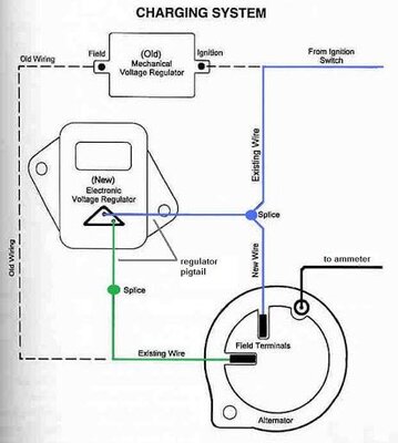

Greetings y'all. New to the world of The Leaning Tower of Power world, and have a couple of questions. Just purchased a '63 Valiant & need a little more amperage for upgraded lights, electric fan, etc. Thinking about using a alternator from a 73-75 (60 amp unit) Have upgraded the charge output wire, wondering about the voltage regulator. Standard shows 2, a VR101 for 36–45-amp unit, or a VR106 for the 60-amp unit. Wondering if there is a significant difference between the two? Electrical is not new to me, but some of the Mopar layout has me scratching my head...

Read this and this. Then, if you will be using a '70 or later alternator (w/two field terminals), go ahead and use the regulator meant to go along with it. That's this one (fancy; seller has needed connector and can coach you on wiring this into your '63 car if the diagram I'm posting here isn't enough) or this one (less expensive, with connector).
Careful about your lights; there's a mountain of garbage on the market fraudulently hyped as "upgrades".
Also, careful about your alternator selection; "remanufactured" ones are junk. Old Car Parts Northwest probably still has some new old stock Chrysler units on the shelf.

I've upgraded the charge wire, 8ga thru a 60a midi fuse, as you specified in an earlier post, now ready to install a 60a alternator. Assuming 14ga wire will be sufficient for the regulator connections? Also planning on upgrading the battery cables to 2ga. The ground currently goes to a bolt on the water pump. Thinking of moving it to one of the bellhousing bolts near the starter & adding ground straps from the block to the body & a lead from the ground side to the core support. Thooughts?
Actually I recommend dual 10ga wires, each with a fuse at both ends. One of the links I provided in my earlier reply in this post explains why.
16 is plenty.
No advantage
Should already be present (was there when the car was built). If not, add.
Ground leads from alternator housing to voltage regulator base to battery negative should be higher on the list.
As far as the headlight relays, I've used Painless in the past with good results
Many others have had opposite experience with "Painless". There's also a lot of poor-quality so-called "upgrade" lamps and lights to avoid.

[/quote] Ground leads from alternator housing to voltage regulator base to battery negative should be higher on the list. [/quote]
One continuous wire, Alternator housing, to regulator base, to the negative post?
PostPosted: Sat Jun 01, 2024 3:14 pm
Or separate wires from point to point to point. Either way is fine.
