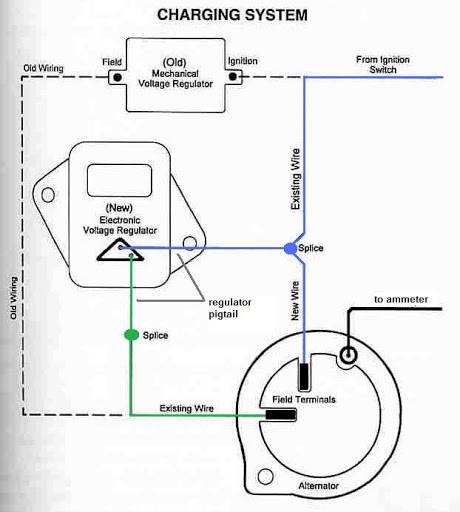

Read this and this. Then, if you will be using a '70 or later alternator (w/two field terminals), go ahead and use the regulator meant to go along with it. That's this one (fancy; seller has needed connector and can coach you on wiring this into your '63 car if the diagram I'm posting here isn't enough) or this one (less expensive, with connector).
