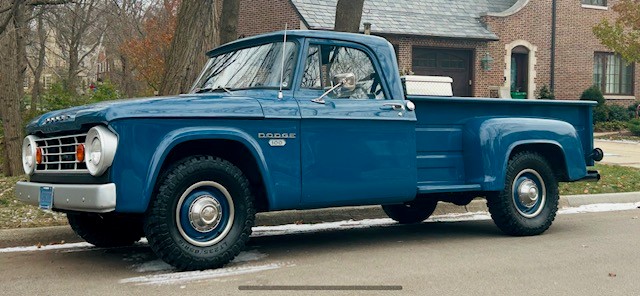

I upsized the tires on the stock rims to LT235/85R16 Tires last month. That helped a little but it seems to be working hard going 65.
My main goal is to have a truck that can cruise at 70 MPH and tow comfortably when needed (I have a 18' 1973 Crestliner Muskie Boat and a ‘59 Shasta Camper).
If I'm pissing up a rope with my current mod plan - i'll welcome honest feedback
