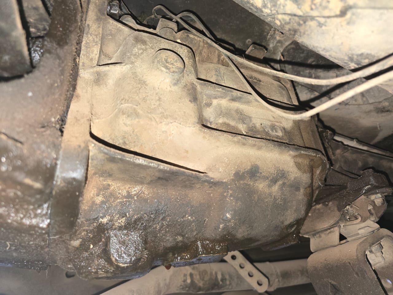

Long story short I cant identify my transmission so i can use a drive by cable to measure the speed. And i dont want to spend $400 to keep my oem one. Just not worth the money for me. Was wondering if anyone has tried this gps speedo and how they retrofited it inside the dash. Since this speedo is 3 3/8 inches diameter and the stock is 5. Any help would be great.

I saw that post, but only saw a picture of the shifter. Can you do a picture of the trans itself? From the looks of the shifter, it should be a A-833OD trans.
PostPosted: Fri Mar 07, 2025 4:36 pm
Posts: 9092
I don't recognize it from that picture. Do you have any more pictures? where the shifter connects, where the speedo cable connects, etc ? Is it a 3 speed or 4 speed?
I dont have any more pictures. But its 4 speed. Shifter connects in the top middle of the transmission. And it has no Shifter cable.

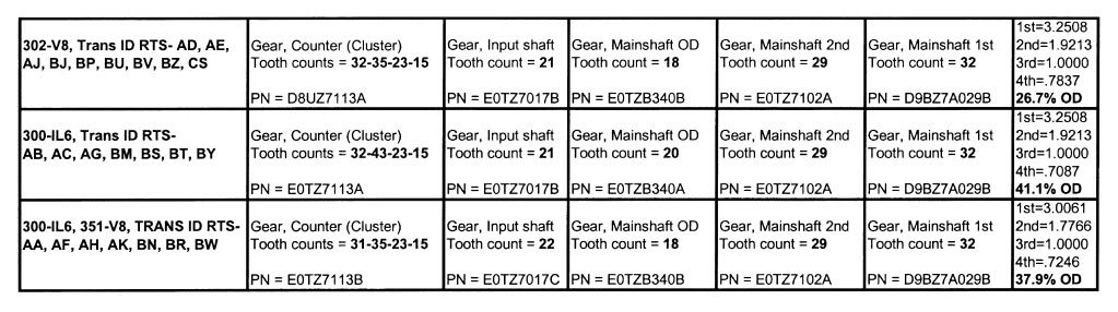

It's a Tremac RTS TOD, from a 1980s F-150.
And I'm not a Ford guy, and know nothing about Ford transmissions.
Now you can go figure out what transmission drive gears they used and decide what you want to do.
