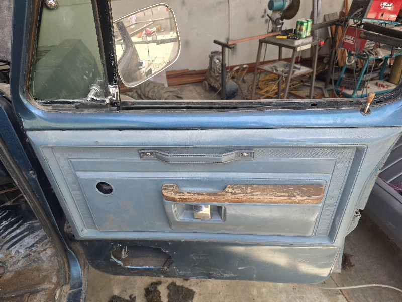

What color door panel is this? Trying to restore it. Should i put a base coat on it as well? Anyone recommend what paint to use.
Mmmmm…that looks liiiiiiiike…
…blue! :mrgreen:
See here
Or if you don't have those kinds of paint-mixing resources local to you, then scrub with dish detergent and a bristle brush, then this, then this, then this.

If you are talking about the plastic door panel, one trick you can try to get the original color back is to use a heat gun to carefully heat up the plastic. Just don't get it so hot that it melts. By heating up the plastic the original dye is drawn back to the surface. Of course, that plastic is very susceptible to UV degradation due to exposure to sunlight, so I favor making new panels covered in fabric. Plus fabric just feels nicer than plastic.
There are lots of videos about this:
https://www.youtube.com/watch?v=-BWmbyywc6k
But if you want to paint it, head over to autocolorlibrary.com and look up you specific vehicle year and find the interior paint code.

I do not have that paint place. I was gonna rattle can it.

Fabric or vinyl? I would have too look into that. I also want the wood handel as well

Fabric or vinyl what? Your door panel is plastic. The handle is vinyl. The arm rest is supposed to be vinyl and you cna purchase reproductions.

As stupid as it sounds aerosol Plasti-dip works really nicely. Get it very clean and scuff it up some with a good stuff brush. There used to be a decent color selection of canned plastidip including clear gloss, but lately I only see black cans. On flat clean surfaces it leaves a slightly pebbly grippy texture that should work decently with the original texture of the door panel.
