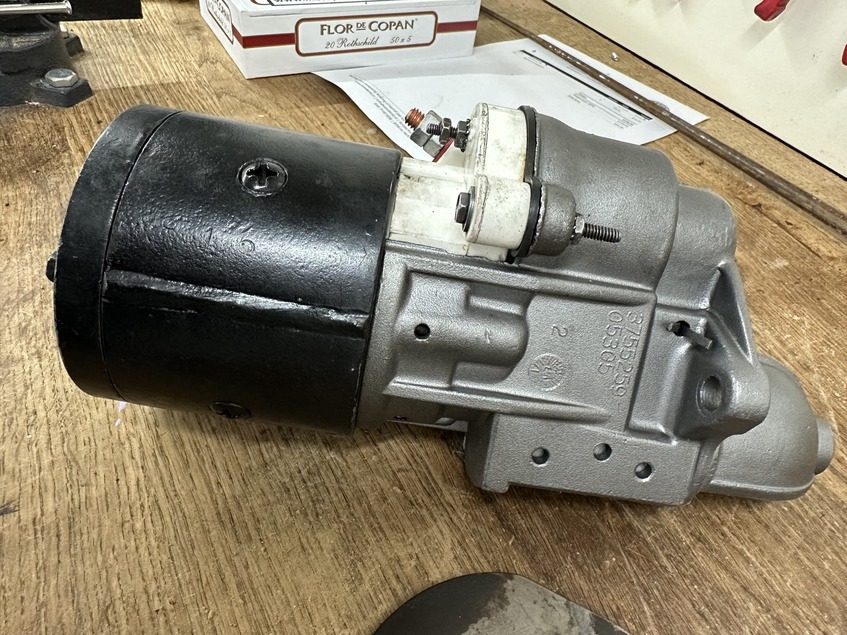

Turned out the coil inside was bad. Found another one
 Post subject: Re: Starter
PostPosted: Sun May 25, 2025 5:00 pm
Posts: 24926
You're in for a surprise when you install that starter and turn the key. That is a remanufacturer's cobble-up of a '74-and-later large-frame starter. The field coils, the armature, and the motor housing are all about 1.5cm longer than the small-frame starter. This kind of starter runs much faster than your car's original starter, has 2:1 gearing instead of 3.5:1, and doesn't sound anything alike.
The large-frame starter did not replace the small-frame one; both were manufactured and factory-installed from '74 to the end of that kind of starter in 1987. The large-frame starter was first installed on the biggest V8s Chrysler made in '74. Starting in '75, the large and small starters were used on various engines, from the 225 Slant-6 on up through the 440, seemingly at random. Some years, a certain kind of engine would get the small-frame starter. Other years, that same engine would get the large-frame starter. No consistency to it; my best guess it was a symptom of the administrative mess that was Chrysler in the '70s.
"Cobble-up" because what we see here is the small-frame motor housing with a ~1.5cm spacer ring between the end of the housing and the rear bearing plate, to throw together a large-frame starter out of a mix of small- and big-frame starter parts.

you've got to be kidding me...
it sounds more or less the French way of putting a car together. When trying to find parts for my Renault it is quite often impossible to get the right part on the VIN number, e.g. brakes, it could be 3 different brands that where put on and you just have to see what you've got... not registered on VIN
the problem with the starter is the coil inside is broken and that seems impossible to be fixed. Nothing else in the NLs is to be found so I have to get one from the US then shipped to me.
No joke.
More or less, but Chrysler did it because they were broke and badly mismanaged. The French did it because they're French.
That's one problem with it — very good odds the rest of its parts are worn or degraded, too. It's old.
any advice
Yes: pick one of the № 3250 starters in the eBay link I posted in this thread before.
Flat, hard, loud no. They're a garbage company, selling garbage parts at OMGWTF prices.
