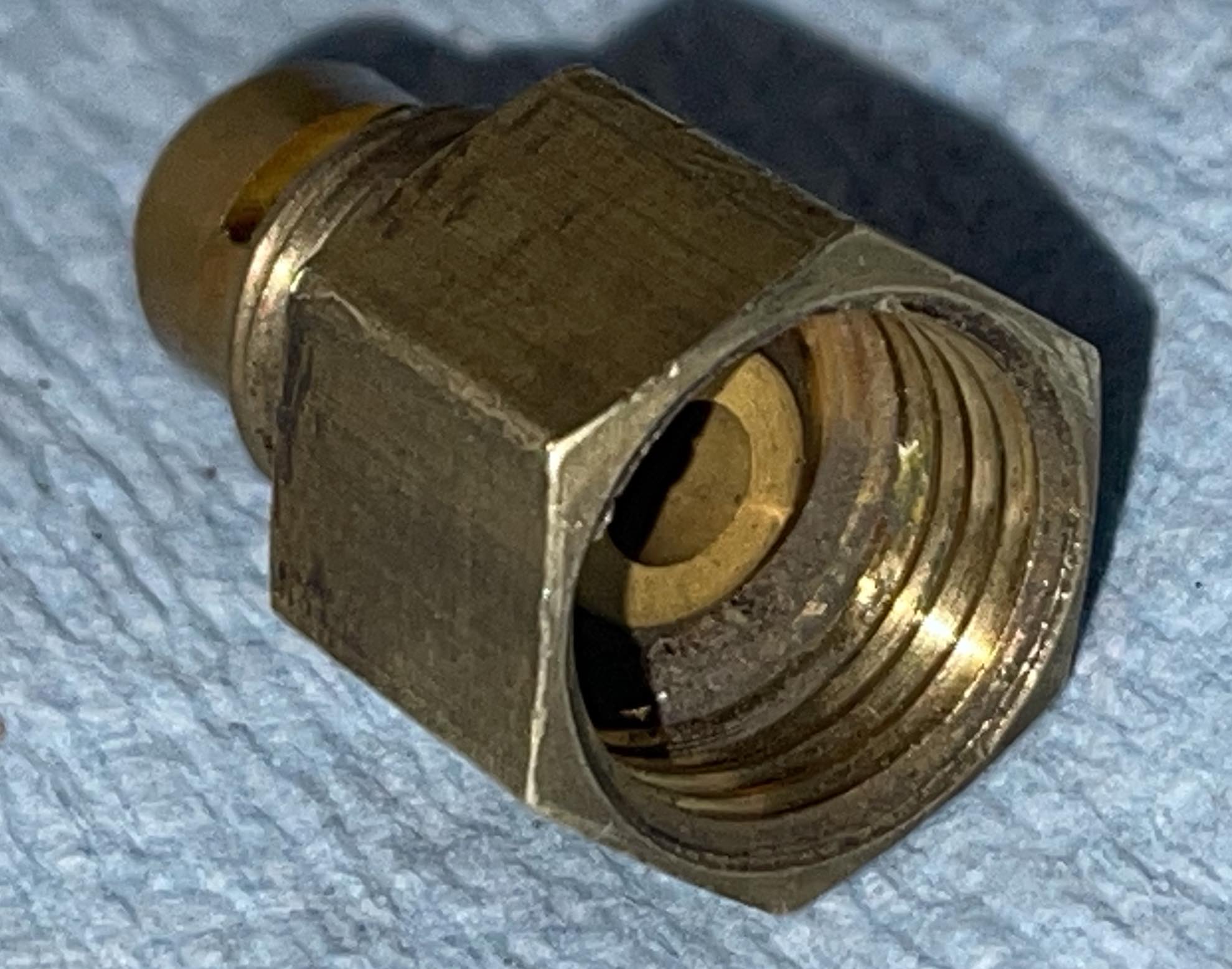

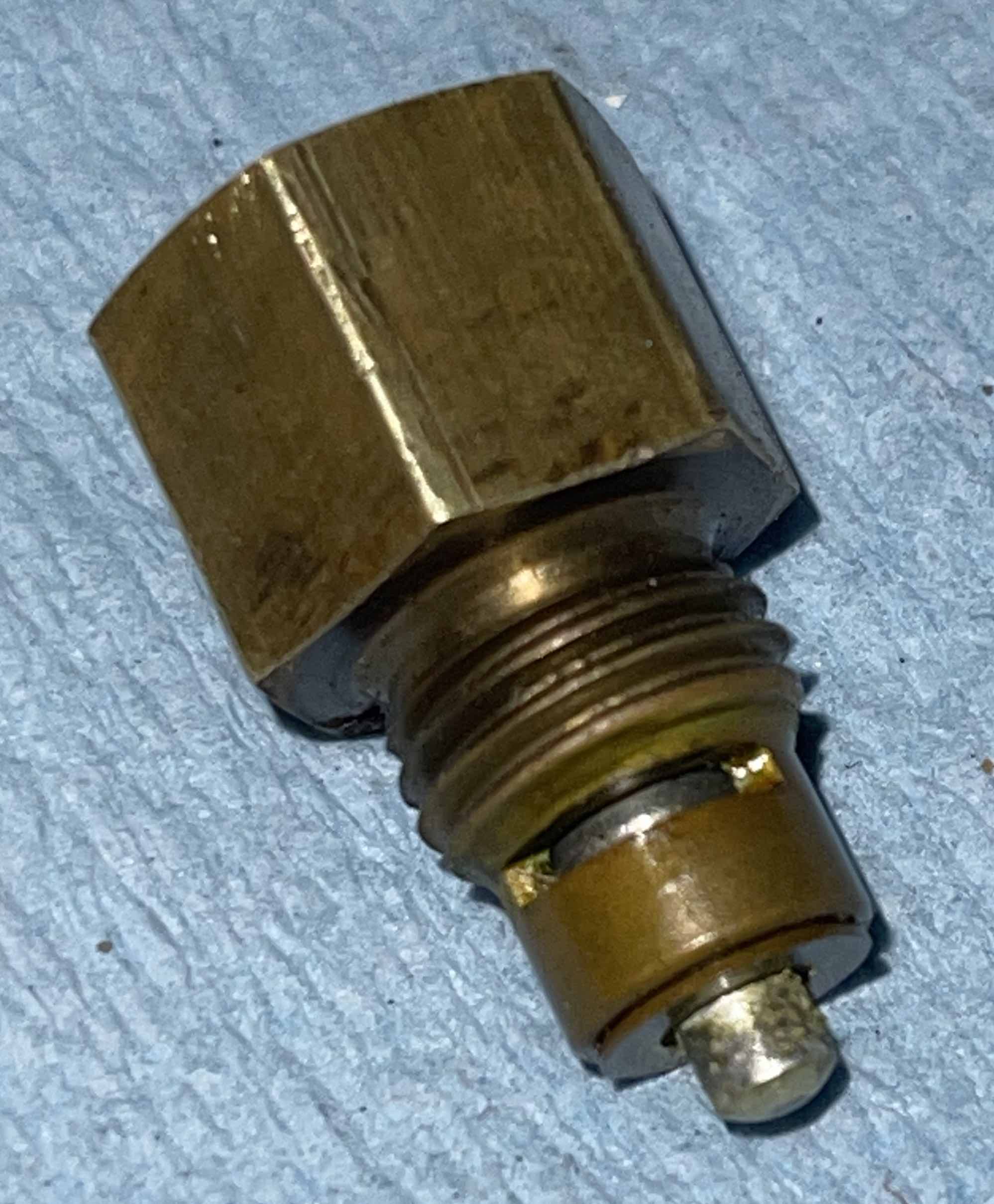

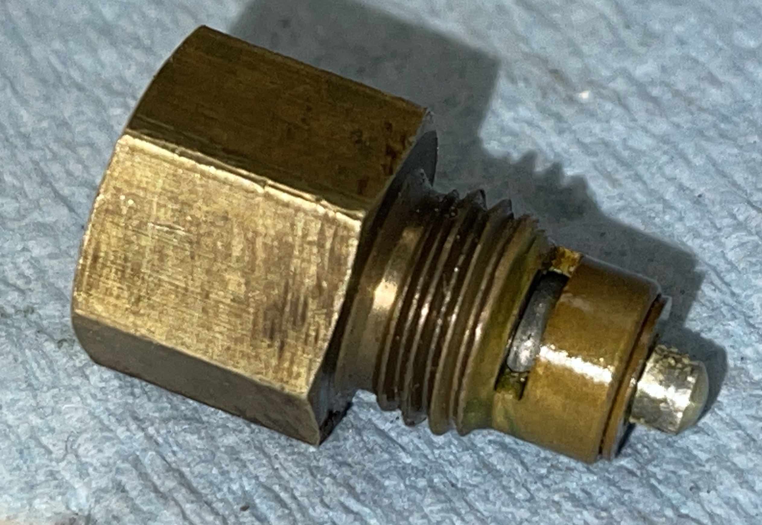

More I think on it, more I suspect your float valve is making a pest of itself. That "Daytona Float Valve" they claim is so much better than a regular ol' normal ol' boring ol' inlet needle and seat, that's a copycat of the old Tomco "Duro-7" design, and — assuming it was a good design in the first place — something might've got lost in translation. I can think of a few ways a not-quite-faithful copy would cause problems such as you're having.
I've probably rebuilt this carburetor at least three times in the last 15 years. Only this last rebuild did I finally try that "new" Daytona float valve you say is a copycat design. I've tried using it in the past and had problems with it. The first two rebuild kits from Daytona came with two different options for the fuel inlet: 1) their 'new', copycat design, and 2) some kind of a brass fitting that has some sort of pressed-together plunger-seal valve. I ended up using that one because it worked. I saved that fitting: perhaps I'll re-use it for now. Pictures of it attached, below.

That's a Holley-type design which works well on certain Holley carburetors. It does not belong in your Carter carburetor, where its side-discharge configuration will tend to make gasoline want to exit the carb through the bowl vent…in exchange for zero benefit.
:!: Ahh....no wonder the bowl vent area has appeared wet for years. Never put that together. Well...shoot. Need to change that out to the tried and true needle/seat.

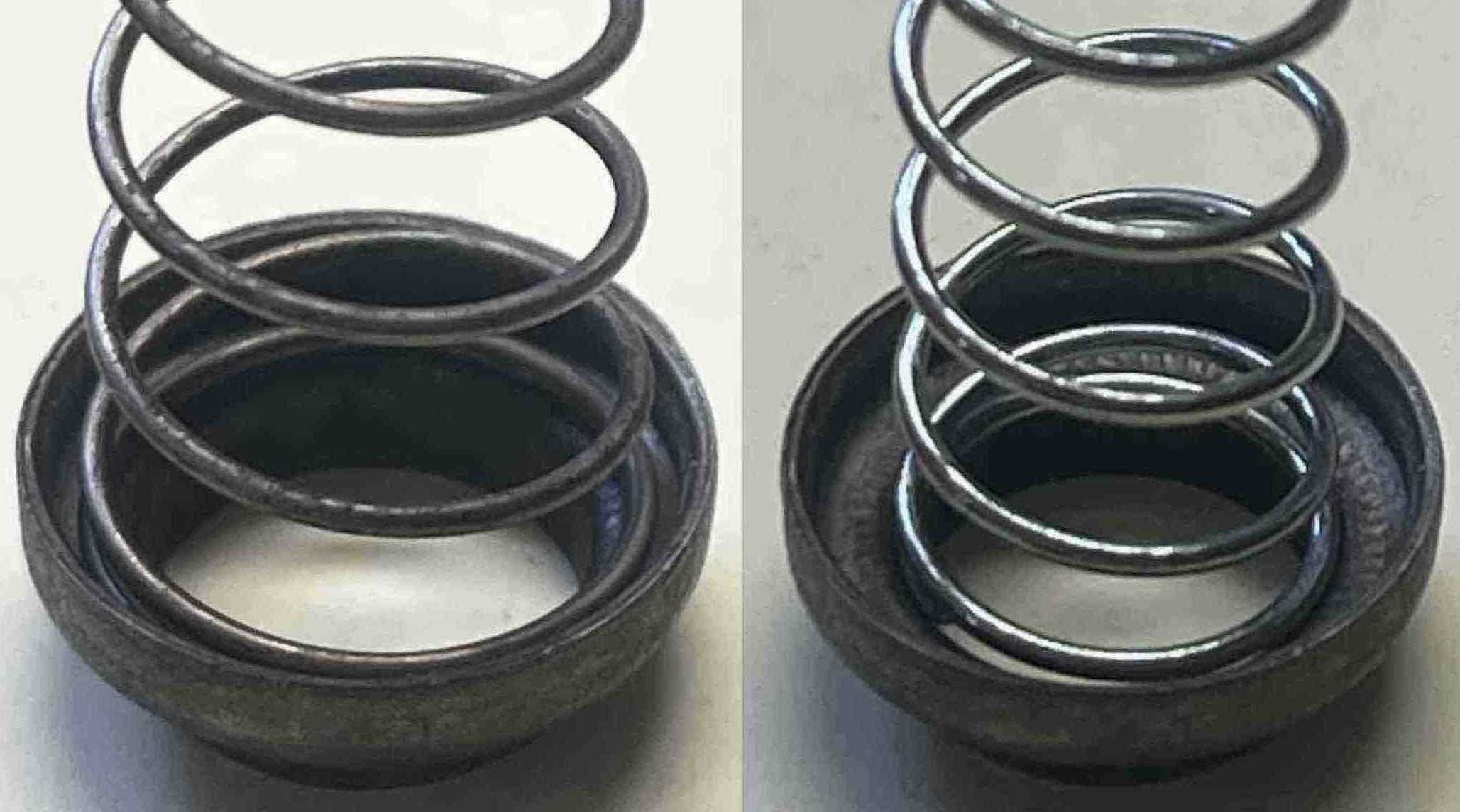

I opened the carb back up not only to install the correct needle and seat, but also to inspect the check balls to be sure they weren't stuck, and to find out why I'm not getting a healthy squirt of fuel whenever the accelerator pump engages. Turns out, even with my normally-diligent carburetor cleaning, there were nearly invisible, gummy deposits clogging the inside of the accelerator pump jet. I had to get out a sewing needle to help clear the passages. Once clean, a pump test with fuel in the bowl finally resulted in a relatively light spray of fuel through the jet into the carb throat. Good. Re-calibrated the float levels, then re-installed the carb.
For a short time, the driving/running improvement was noticeable. I'd step on the gas, there was no stumble. I could actually observe the pump working. Then, I noticed that sometimes the pump sticks. You'll work the throttle linkage and the pump will plunge down slowly, if at all. I know I've done the preconditioning of the leather cup correctly, and after driving it last night when it was stumbling all over the place, I'm thinking my accelerator pump spring may be the issue.
I have reused my old pump spring many times because it seems tapered correctly from narrow at the plunger end, to wider at the top end to mate with the metal 'cup' that seals the pump vent hole. The new accelerator pump springs that come in the Daytona kits do not taper at all. Their coil is wound too tightly so the end of the spring that rests inside the rim of that metal cup doesn't sit around the edges of the cup correctly to press it firmly up against the inside of the airhorn; all the spring wants to do is poke through the center hole of that cup seal.
Given I'm going to have to open the carb back up again to work through the pump issue, it's worth asking: is the pump spring supposed to be tapered? Or is it supposed to be straight, and I just have a too-narrow spring? Please give me your thoughts, thanks.

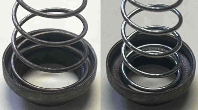

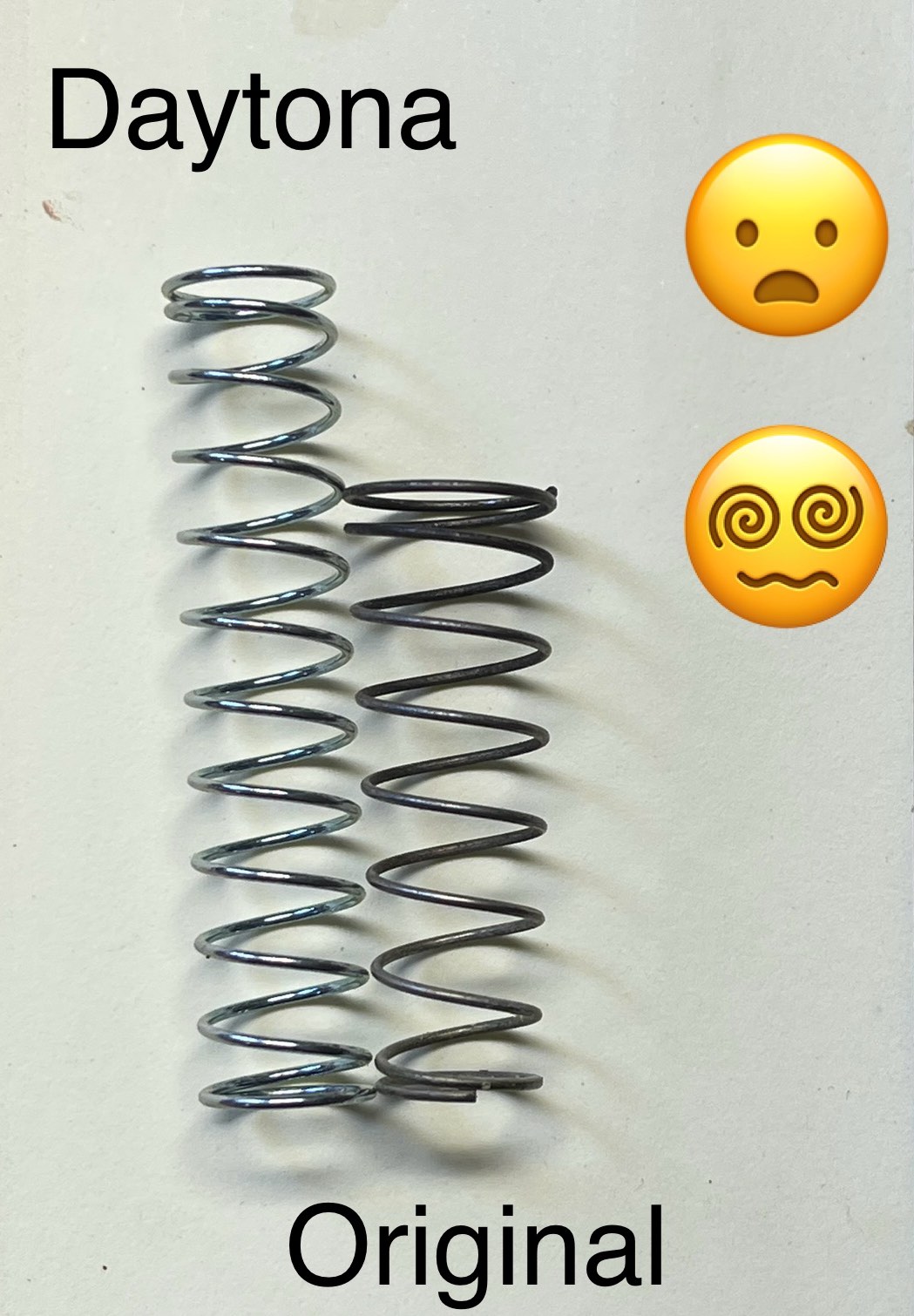

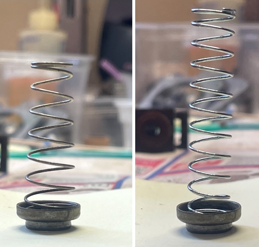

Confirmed; that's the correct design. Carefully stretching this spring pays dividends. Grab it with pliers at both ends and stretch it just past the point where it springs back to exactly where it was before. Not too far, or you'll spoil the spring. You want it to wind up just a little longer than it was.
More I hear about Daytona's kits lately, dimmer my view of them. This plus the other bum parts already mentioned move them into the do-not-buy category as far as I'm concerned.

I'm getting back into it right now.
Original spring length measures 1 5/8". Daytona spring measures 2 1/8". Now, I'm questioning their parts, wondering what length is correct. But Dan, you said stretch the original spring so it returns to just past its original length, that would still be a good deal shorter than the Daytona spring...?
PS: MAN, that original spring does NOT want to stretch longer! It keeps returning to the same length and I’ve gone past where I think I’d need to go to get it to stretch. Stern stuff this old spring.

Thanks to everyone who's weighed in on this. Finally got the original spring stretched a bit and reassembled.
Wow. :shock: What a nice difference that makes! No stumble at all. Strong jet of fuel on acceleration. Drives like it should now :D
