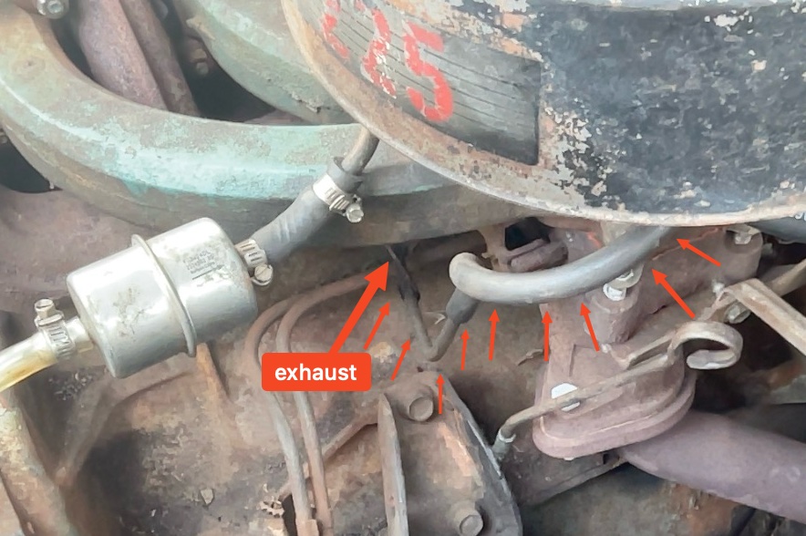

That is exactly the system I'm pointing you at. It is far on the other side of useless with today's gasolines, but the '69 carbs were calibrated for that extra air coming in. Best thing to do for a permanent fix is put a hose barb-to-thread fitting in the carb port and run rubber hose directly to the nipple on the underside of the air cleaner, and remove the steel tube. But it would be interesting to try capping the carb port (and plugging the air cleaner nipple, which is on the clean side of the filter so you don't want dirty air getting in) and see what effect that might have on your idle situation.
That nipple connection under the air cleaner is already connected to the exhaust manifold underside via rubber hose.
See below:
And what should I use to cap this nipple coming out from the exhaust manifold that was previously the metal anti-ice line? Will need to resist some heat...
See below, and also curious what that screw is for in the head:
Factory config is air cleaner nipple -> rubber hose -> steel pipe to bottom of № 2 exhaust runner -> insulated steel pipe from top of № 2 exhaust runner --> carburetor.
What you want is air cleaner nipple -> rubber hose -> carburetor.
Nothing; it doesn't need to be sealed at either end; there's nothing to seal. It's just a straight-through tube.
