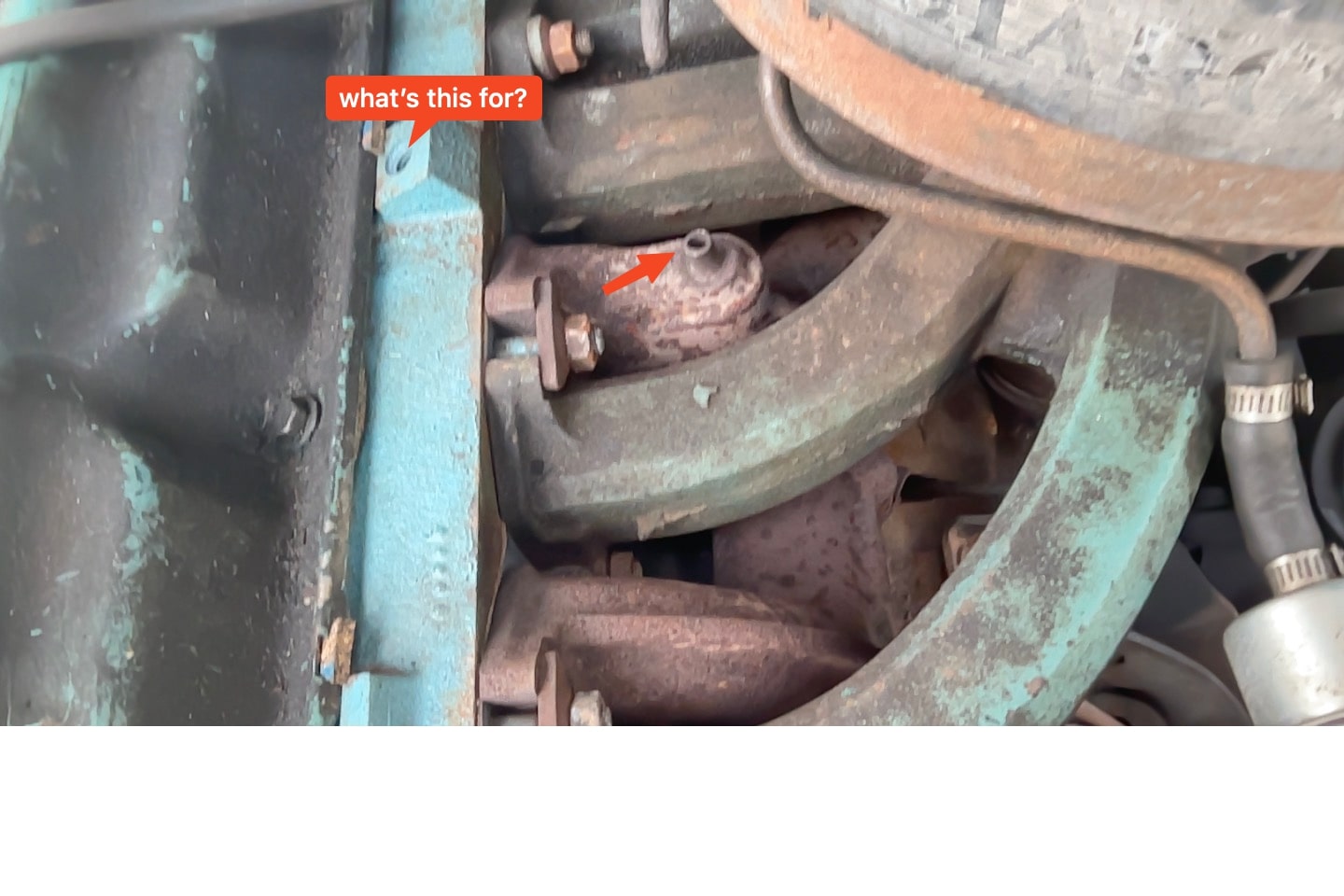

And what should I use to cap this nipple coming out from the exhaust manifold that was previously the metal anti-ice line? Will need to resist some heat...
See below, and also curious what that screw is for in the head:
Nothing; it doesn't need to be sealed at either end; there's nothing to seal. It's just a straight-through tube.
Lifting the engine.

That explains that.
Neat.
