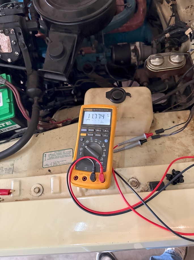

Today I went back with a proper multimeter and did more tests. At the positive coil post, with the ignition on, and multimeter grounded directly to the battery I was only finding 10.12 volts. Battery voltage post to post measured at 12.49 volts.
I did not install the Pertronix system myself, so I looked around a little more. I found where the ballast resistor had been removed, and the connectors had been jumped together. Looks like a fine method to me.

Checking voltage with my multimeter from connector to connector of those wires showed 11.77 volts. So seems like I'm dropping quite a bit of voltage from this connector to the coil.
