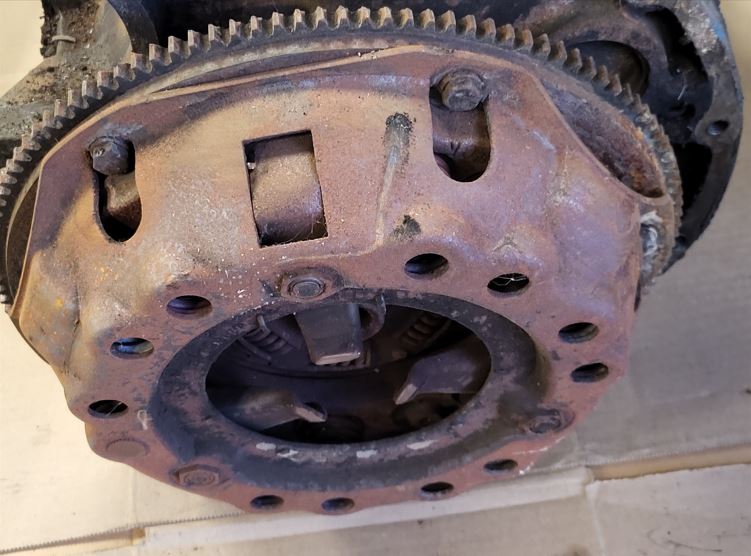

Continuing my flywheel clutch issues.
Now that I know my "cast" crank engine is a forged crank I have moved to clutch issues.
I never had any luck with the 9.5 Borg and Beck pressure plates in my street cars.
Years ago I would buy the 10 inch PP that was listed for trucks.
These are the scalloped covers to use all the flywheel out to the mounting bolts.
That is what is in the Dart now, although it is quite used and of unknown condition.
I spoke to "Joe" at H.R. Clutches and he can build a hybrid clutch from my old cover.
Add 3 springs to make 12 and use high quality spring material for better heat performance.
They are in Bensalem PA.
Are there other solutions for the B&B clutch route?
I have an old WEBER pressure plate (9.5 inch) here but was warned the spring/pedal pressure is "HIGH".

PostPosted: Tue Jan 27, 2026 2:27 pm
Posts: 9354
Stan at our advanced ages, I would not want something that pushes all that hard. I would go with a modern diaphram unit with a good dual friction disc. Was Ram making a bolt in pressure plate for the Slant 6 pattern? I can't remember.

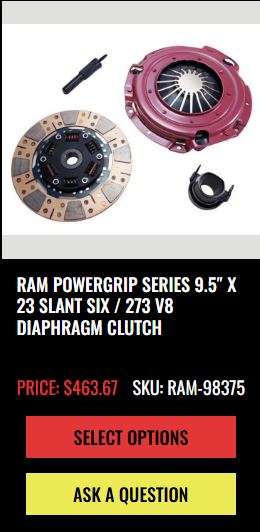

PostPosted: Tue Jan 27, 2026 3:12 pm
Posts: 2647
This is the Brewers package.
Must be used with their flywheel.

PostPosted: Tue Jan 27, 2026 5:43 pm
Posts: 9354
Must be used with their flywheel likely means it is not a Slant 6 pattern pressure plate.
What clutch are you planning?
I am using a 10 1/2" McLeod V8 Clutch & Pressure plate inside a Quicktime Slant 6 blow proof.
PostPosted: Wed Jan 28, 2026 7:17 am
Posts: 10281
I have an old WEBER pressure plate (9.5 inch) here, but was warned the spring/pedal pressure is "HIGH".
Hi Stan,
You can use the 10" Borg and Beck and have it rebuilt as needed by your guy or any other reputable clutch rebuilder, Falcon Clutches, Kentucky Clutch, South Bend Clutch, etc.
I would avoid the 10" for any performance use. In a stockish/driver setup, it will be fine, just avoid high RPM.
If you want to sell that Weber 9.5" unit, please contact me - I may be interested in it.
I have gotten to the phase of my clutch life where I buy the discs/plates / Flywheels I want from different suppliers and put my boutique stuff together. No one really makes a package that I usually want, because.... Slant 6.
You (or a reputable machinist more likely) can drill out your stock flywheel for any clutch cover/pressure plate you want. I have done that here to install a Ford Mazda 10" Diaphghram PP onto the flywheel for my '62 Vlaiant wagon. Works great, and I have towed ~2000# of trailer behind it with the stock/stupid/clunky 903 3 speed.
For the slant 6 stock B&B Bolt pattern, there are 3 options:
1. Stock 9.25" Cover
2. Stock 10" truck Cover
3. **Fiero diaphragm uses this bolt pattern as well** - I need to verify this for sure, but this is my assumption.
I have a smaller Spec ~9" clutch cover that is a diaphragm design (**assumed fiero bolt pattern for the clutch cover) that I have placed in my heavy Volare'-Duster f Body, and it works fine in that car. I bought this from someone who bought it new from the "spec group buy" 15+ years ago.
Some things to consider:
*The flywheel does not care what clutch cover is bolted to it.
*The clutch cover does not care what disc is driving the transmission, as long as it works and has the same spline count as the input shaft, and physically fits (within reason) under the clutch cover.
Happy to discuss further. Give me a call.
PostPosted: Wed Jan 28, 2026 7:18 am
Posts: 10281
Last thought:
If you want the whole deal to be idiot-proof, just buy the ram package.
It's good stuff!
