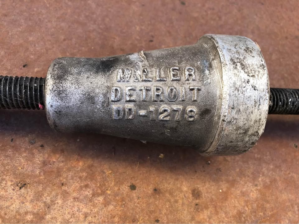

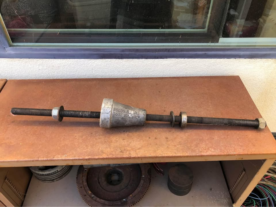

I am about to start rebuilding the front end on my 76 D100 and part of the rebuild will include the ball joints. Factory service manual says that to remove the ball joints i need to get special tool DD-1278 to hold the coil spring in a compressed state once the ball joints have been pressed out of the control arm.
OK, but the cheapest I can find that tool is about $300 plus shipping.
In the pictures, the tool looks like a thick length of all-thread with nuts and washers on each end and an inverted cone between the nuts, like a slide hammer weight. If I knew the bolt size and thread pitch I am confident I could throw together a reasonable facsimile of the tool using simple hardware, but I don't know those details.
465579709_423937923884626_2709516473816657833_n.jpg [ 114.85 KiB | Viewed 5677 times ]
465541149_1711274623051560_1329597818416933716_n.jpg [ 88.25 KiB | Viewed 5677 times ]
Is anyone aware of a reasonably cheaper alternative to this coil spring compressor?

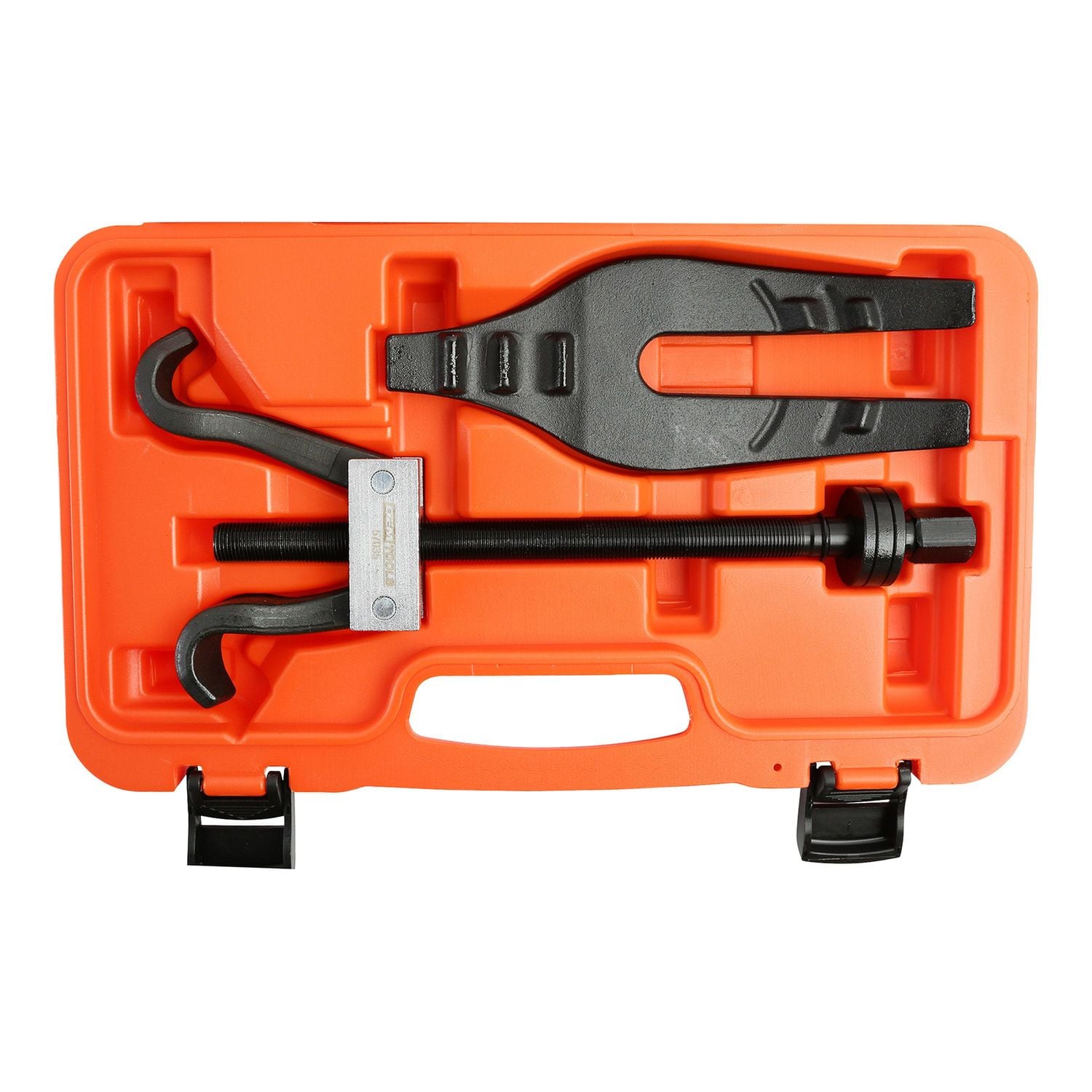

Anybody have experience using OEM 27035 in place of DD-1278?

that lower tool will work fine.
if you set jack stands under the frame, then put your floor jack under the lower control arm and lift til the frame comes off the stand enough to raise it one more notch, you can then lower the jack just enough to settle back on the jack stand. the floor jack will keep the lower control are and spring from hyperextending.

I did find an auction for just the cone part of tool DD-1278. That looks like the hardest part to find. I can buy a rod of all-thread and some nuts and washers locally. Then again, I already own a floor jack.
