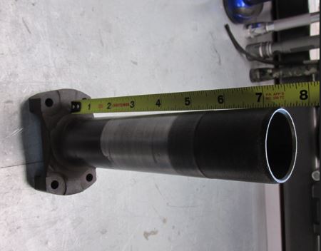

I have a dummy yoke here I use in my transmissions when I remove them or work on them.
Its 7 inches long.
It has 3 inches inside with no splines.
I can move it into my 3.09 gear box all the way to the where the seal bottoms.
I have the 1 inch real seal, with dust boot, not just a short seal.
It is 30 or 31 spline.

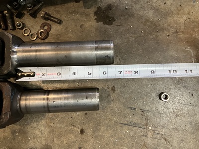

Here is the yoke before I cut it off. I cut just about 1" off and retried inserting it. No go! It is still about an inch further out than I think it should be. The splines go clear up to the end of the yoke, so I would think it would go in almost to the seal.

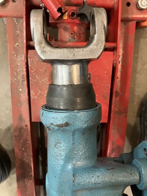

Here is where it stops. I tried bumping it in and it does not seem to hit solid.(Like metal on metal) But it just seems to get tight and stop. Guess I need to look at the exploded view and see whats up? Probably remove the tailshaft? Any brilliant ideas welcomed.

The problem is the yoke itself. I cleaned it out real well so I can see down the splines and they are definitely twisted. That is why it goes in and gets tight but not like metal on metal. The splines are just getting tight were they are twisted.
New yoke for a 7290 U-joint is on the way! Dr. Diff come through again! :D
