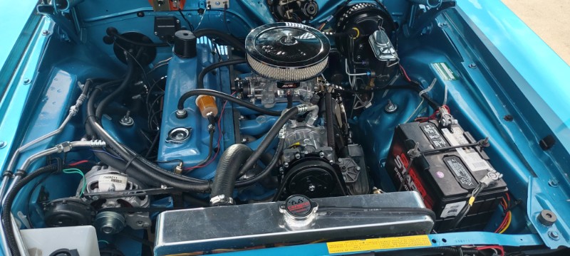

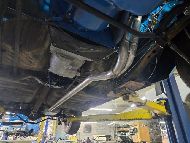

I'm just about finished with the restoration, it should officially be on the road by the end of August.
Original 225 slant 6. Bored .030 over. .90 removed from deck and head. 9.25cr. head ported/polished/gasket matched, back cut the valves, 340 springs. Fully balanced. BB rear one piece main. Smoothed casting lines at the water pump and did the oil pump/passage cleanup. Dbl roller timing. Flowkooler water pump. Offenhauser intake, Clifford headers, Edelbrock AVS2 500. Bouchelon engineering for the AC bracket. I'm sure I'm missing a couple things, but that's the general gist of things.

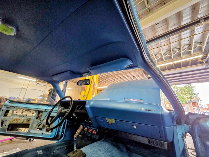

I upgraded the three-speed manual to a 4-speed OD. Upgraded the week 7.25 rear to an 8.75, 3.55 gears and a sure grip. Upgraded to front disc brakes. Kept the manual steering, but upgraded to the 16:1 ratio box. Bilstein shocks. Radiator upgraded to aluminum with electric fans. Lots of sound deadening installed.
I refuse to buy a new car now, I'm sick of all the electronics and the huge touch screens and other bs, so this is going to be my new daily-ish driver, so I built it with safety and comfort in mind.

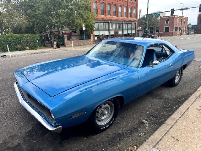

It's almost finished, either end of this week or middle of next at the latest. I got my new plates as well. I tried the photo resizing thing, let's see how that works.
