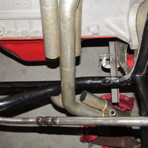

Posts: 2701
Started cutting pipe. I thought just one of the last three would need fitting, but it looks like all 3 will have to be changed. I am also going to remove 2 pipes from the head flanges to clear the Clifford intake.

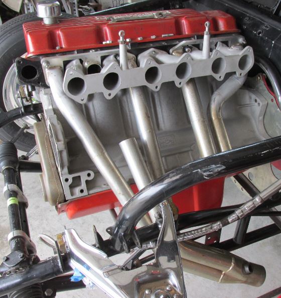

Posts: 2701
I feel like a 90 year old man today.
Does any one remember the header Ad from years ago?
It was Hooker or Appliance or another one and this poor guy was under the car with pipe knee high.
The caption says, "Mike Failed Today"
That is how I feel today.
This is where I stopped for the day.

Posts: 1464
Would it be possible to angle mill the intake, where it bolts to the head? It would tilt the intake up and might give more clearance for the inner header tubes.
PostPosted: Mon Jun 01, 2020 5:35 pm
Posts: 9438
And likely mess with the Weber carb operation. :D
