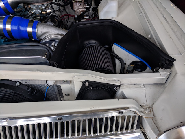

Added some pics of my custom ram air to the CAI. Not sure if it helps, but if it is good enough for a Hellcat, then its good enough for Rodger.

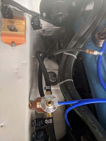

I went ahead and did the fuel line mods. I even added a Ron Francis CR-92 collision switch with relay, just in case.
The results are smoother acceleration and no hiccups at high RPMs. Running new gas line was a pain, but guess what I found… Yep, a ding in the old line crimping it about half shut. Now I’m not so sure that I needed to upgrade. Hmmm.

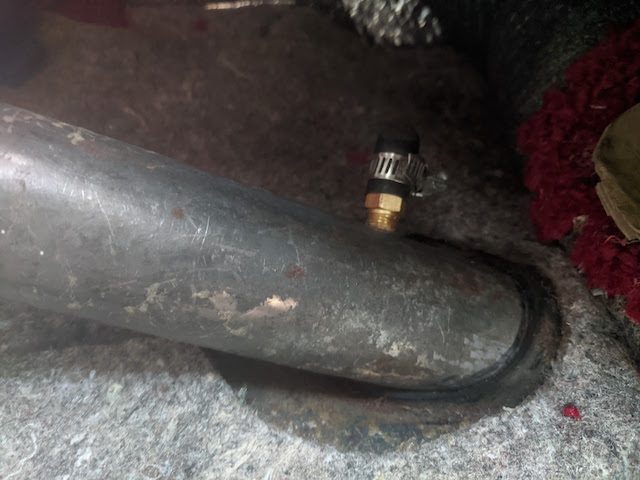

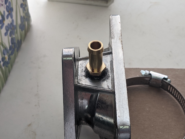

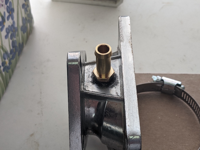

No PCV outlet on new carby setup. I used the 6th rail plug, but found a post by SlantSixDan that indicated this is bad. I tapped a nipple into the adapter and ran the PCV hose there with the brake assist, boost gauge and BOV hoses going to the sixth rail nipple.
I didn’t fully read the electric fan installation manual, who does? Anyways, I missed the bit about reversing the blades if changing from puller to pusher. Easily done once the fan was removed and it is much quieter and probably more efficient.

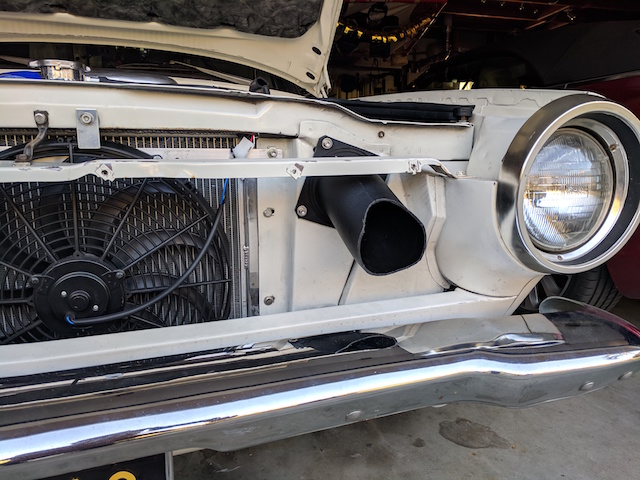

I spiffed up the Dart a bit by adding a fan shroud, which helps keep it cool at idle.

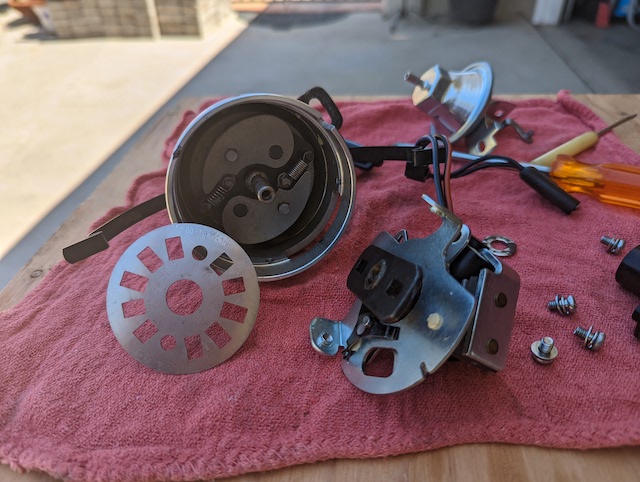

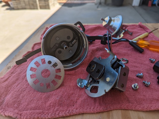

Also, I added a distributor advance limiter from FBO Ignition Systems. I have read that the magic number of 28 degrees total timing is a good place to be on a supercharged Slant 6. I set the initial timing so that the engine is running its best at idle. This turns out to be 10 degrees BTDC. Based on this, I chose the 14 degree slot on the plate. This is because I have read that a slant six is about 2 degrees further advanced than what is stamped on the plate and therefore will give me a total timing of 26 degrees. A little less is better, because too much causes pre-detonation and will damage the engine. Checking the timing seems to bear this out and the Dart runs better and starts easier with this setup.

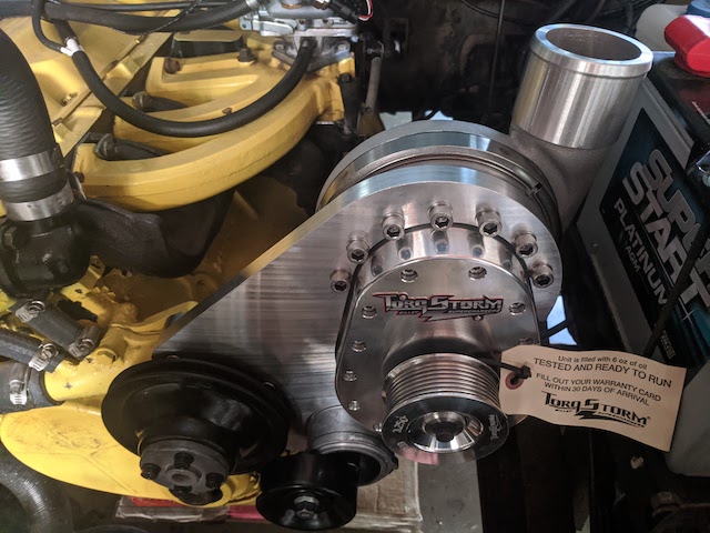

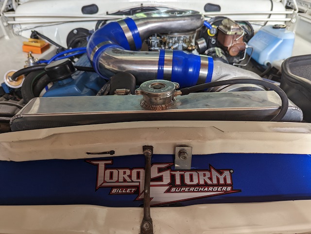

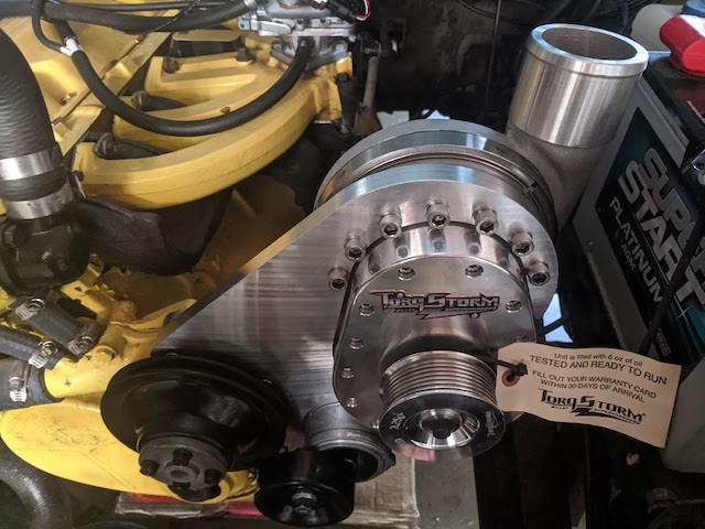

I got my TorqStorm for my D100 and will just highlight what I did the same vs different from the Dart.
Same:
Manifolds heads and block are all stock 1966 single barrel slant 6
Ordered the supercharger with the smallest pulley 3.5 to get boost at the lowest rpm.

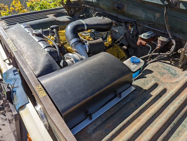

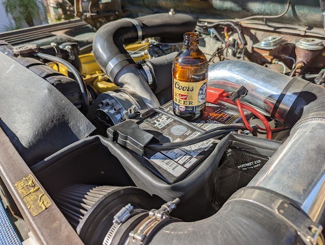

Plumbed in a custom CAI enclosure with 3.5" tubing and K&N filter. That is my first attempt. After drinking the brain lubrication I decided to relocate the battery to the frame and reduce all the plumbing, which is what I have now. The cover, made from PALight Foamed PVC, is removable for cleaning the filter.

Used a Weber 32/36 DGV carburetor with an adapter to the single barrel stock manifold. Tapped a nipple in the adapter to feed the PCV.  Jets - Primary air 160->145, left the Main at 145, Secondary air left at 170, Main 150->200. Manual choke since I had the linkage. The choke is only used for fast idle and the electric on my Dart sometimes went off fast idle too soon maybe I  need a resistor.

D100 is 3 on the tree. It appears that the Dart automatic  torque converter helps reduce the blowoff valve activity while decelerating. Added Uni foam sock over blowoff valve as recommended by TorqStorm to make life bearable while going downhill.
Did the nipple on the fuel pump atmospheric port to hat simulating boost referenced regulator. Added an electric fuel pressure gauge to keep track and so far so good.
Used the hat provided by TorqStorm
Upgraded voltage regulator to vr128.
