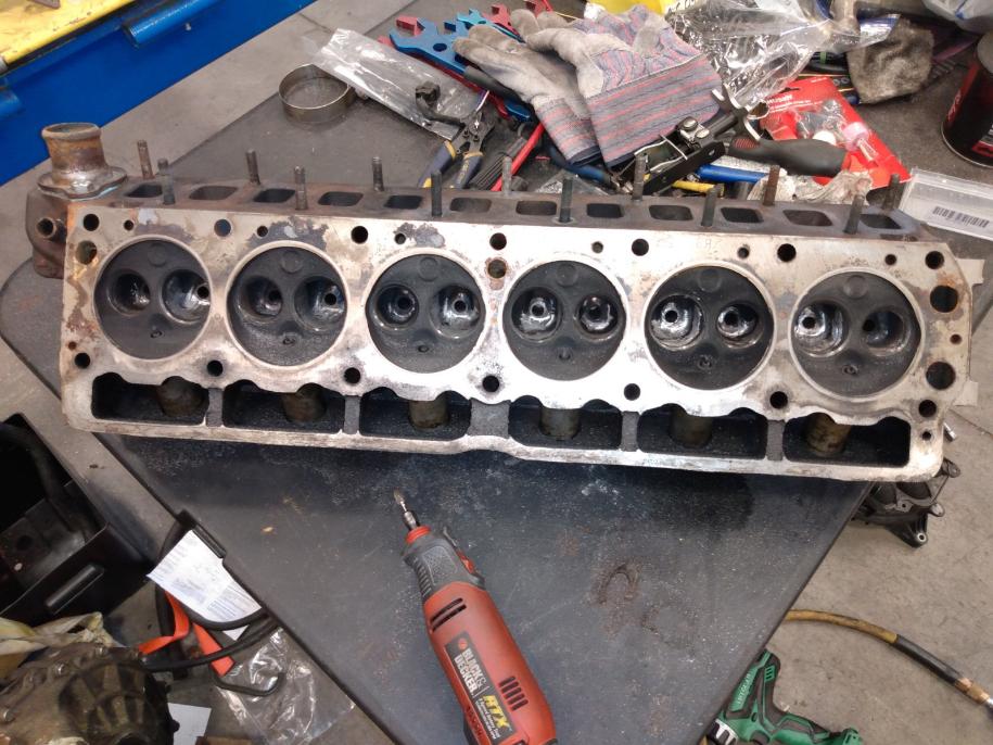

Finally back on this one. The cylinder head has been ported and gasket matched, as has the intake. The exhaust manifold did not need any gasket matching.
File comment: Cylinder head porting
Then I dropped the head off at the machine shop for a valve job and cutting the valve guides down for more clearance and positive type valve stem seals. Still waiting on that.

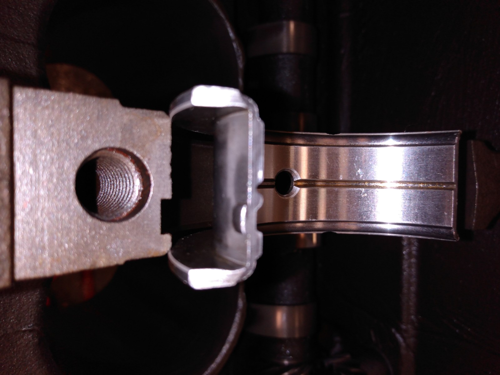

But then it turns out some of the items I've ordered aren't quite right. The freeze plug set didn't include the cam plug. Is there supposed to be some sort of thrust bearing on it? And the bearings listed under part number BC321J - Rockauto lists these as correct for a slant six as of today - definitely aren't right.
File comment: Wrong bearings.
Then I realized I had five sets of bearings instead of four... looks like they sold me a set of small block V8 bearings.

No cam thrust plate/washer on a slant,,,
Lot of folks do the rocker adjusting screw welded
into the timing chain cover routine.
Thanks, I'll do something like that - particularly since I'm going to be using the Rollmaster double roller timing chain.
