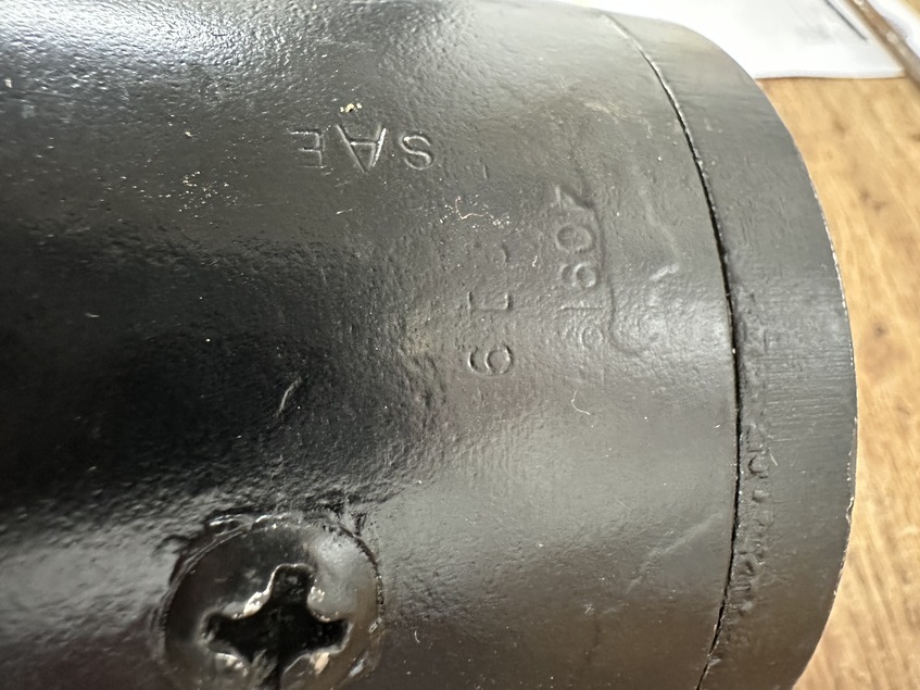

There is not enough information in these photos to say anything substantial about the condition of this starter. Tooth damage is not a common failure mode.

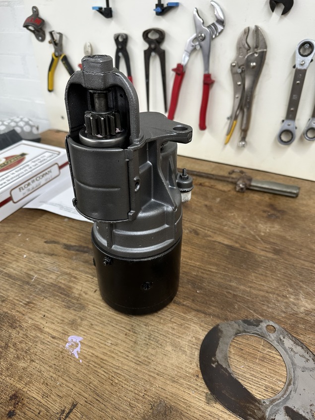

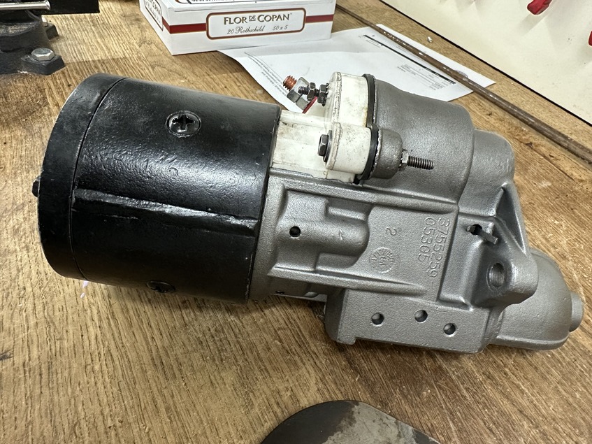

Turned out the coil inside was bad. Found another one

You're in for a surprise when you install that starter and turn the key. That is a remanufacturer's cobble-up of a '74-and-later large-frame starter. The field coils, the armature, and the motor housing are all about 1.5cm longer than the small-frame starter. This kind of starter runs much faster than your car's original starter, has 2:1 gearing instead of 3.5:1, and doesn't sound anything alike.
The large-frame starter did not replace the small-frame one; both were manufactured and factory-installed from '74 to the end of that kind of starter in 1987. The large-frame starter was first installed on the biggest V8s Chrysler made in '74. Starting in '75, the large and small starters were used on various engines, from the 225 Slant-6 on up through the 440, seemingly at random. Some years, a certain kind of engine would get the small-frame starter. Other years, that same engine would get the large-frame starter. No consistency to it; my best guess it was a symptom of the administrative mess that was Chrysler in the '70s.
"Cobble-up" because what we see here is the small-frame motor housing with a ~1.5cm spacer ring between the end of the housing and the rear bearing plate, to throw together a large-frame starter out of a mix of small- and big-frame starter parts.
