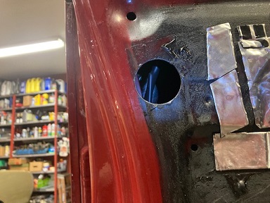

Completed another item on the D150 do list. I had installed automatic door locks back in 2012, they are handy, beats having to reach across the cab to lock or unlock the passenger side door. Problem is that this was the third time that the clamps that were supplied with the door lock kit worked loose. Making the door auto door locks non functional. Every time the door would be closed the clamps would get a jar and I think that is what would knock them loose, the up an down motion of the clamp when the door lock is operated is not severe.
I considered changing the philips head set screws to allen heads to be able to apply more tightening force and also putting a drop of loctite on the threads. Also I believe I needed to put a larger access hole in to able to get to the clamp and really tighten the fastners
Then I had an idea, how about instead of a static friction clamp like a set screw clamp, perhaps an elastic compression clamp would stay in place better. I tested a piece of heat shrink tubing. The same heat shrink tubing normally used to insulate electrical joints. I used it to hold two wire sections in a parallel clamp. It had really strong hold in an up and down motion. The heat shrink tubing that I used is the Marine grade variety, it lets out an epoxy sealant internally when heated.
So that is how I attached the auto door lock actuator rod to the OE door lock push button rod. The two actuator wires over lap by a little over an inch and the heat shrink tubing is another inch on each end.
I believe this is a good fix

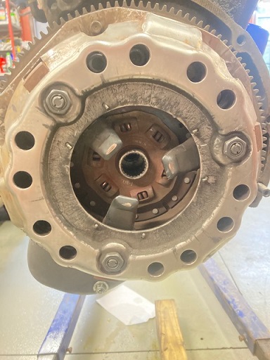

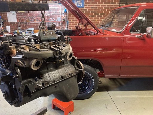

Pulled the motor from the 83 D150 yesterday. I had changed out the clutch - pressure plate and TOB in the summer of 2017 due to the plastic TOB housing breaking apart.
As time and use went on I had to adjust the clutch several times to get the the transmission to shift properly. It would shift fine the first couple of miles, then as things warmed up it would be more and more difficult to shift with out some gear crashing, So I would run the TOB in some more and it would be ok for a while. Finally got to the point where the TOB was running on the clutch plate fingers.
I know that is not right.

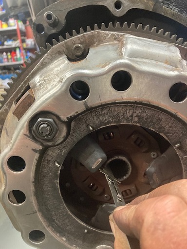

With the clutch plate mounted on the flywheel I measured and found, from high to low a .260 difference among the clutch plate fingers, measuring from the shinny point of the clutch finger where the TOB runs to the OD of the splined center section of the disk.
I can see a visual difference in the heights of the adjusting nuts - studs that are used to set the finger height. They are certainly not finger loose, but it appears that they are not locked in place and are changing while in use.
So I am clutch package shopping again.

I've had the clutch fingers go out of adjustment myself. We're at a point in time where 3-finger Borg and Beck clutches are severely dated. There used to be clutch and brake rebuilders all over who understood this stuff, but not so any more. A good friend was given a clutch cover fixture for adjusting clutch covers like the B&B. If I had the fixture I'd be tempted to fix something like this myself, but it's less labor to buy a new kit with cover, check the finger height and spot weld the adjusters so they stay put.

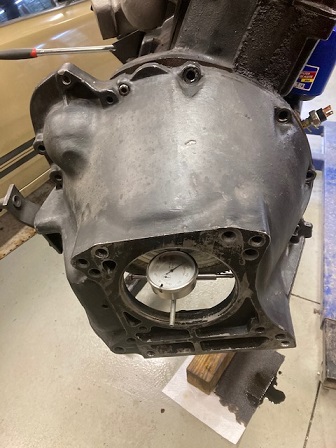

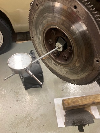

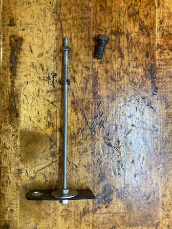

working to make everything as good as it can be, among other things went through the bell housing bore alignment.
I have a magnetic base, but I always bump or move it when removing the bell housing for a recheck. Made the fixture shown in the photos below,
rigid enough to be repeatable, does not get in the way of removing - reinstalling the bell housing.
I put in a set of the robbmc dowels, these are nice pieces easy to work with.
https://www.robbmcperformance.com/products/dowels.html
I have the bell housing bore 0 to 0 East to West and .005 to .005 North and South.

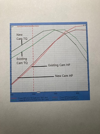

I had pulled the motor to address a clutch issue, but since it was out,,,
I am going to install the NOS Mopar Purple Shaft P4529340 Hydraulic cam that I had picked up at the ICH swap meet a few years ago.
The current cam is a 256 / 250 advertized duration the cam to be installed is a 240 / 240 advertized duration so I know that I am going smaller.
The smaller cam gives up some HP and TQ at higher RPM levels, but since I have the 68 Barracuda available, I don't plan to have the 83 D150 racing on a track.
The additional torque off idle and up to highway speeds looks promising to me.
I have the motor down and cleaned up, the plan is to do the cam swap tomorrow.

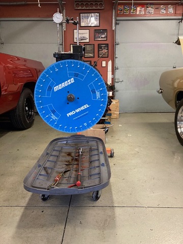

The cam swap is complete, finished up the degree wheel business today.
The ICL is set on 102
I am not doing any other engine work so the static compression stays at 8.49
However going to a smaller cam did increase the dynamic compression about half a point.
Using the UEM dynamic compression ratio calculator with the previous cam the dynamic compression ration was 7.537
With the new cam the dynamic compression ratio is 7.979

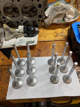

The big project today was cleaning up the intake and exhaust valves. I should have got a before photo, the intake valves had a lot of coking on the back side. I had positive valve seals on the intakes, but it appears that those seals were leaking. I had umbrellas on the exhaust valves and they had some carbon on them but were fairly clean.
I soaked the valves in Berryman carb cleaner over night to soften the carbon build up, then the valves made a quick trip through the blast cabinet.
After that I ran the valves for a bout an hour in the vibratory mill with the abrasive hard plastic pyramid media.
Then ran the valves in the vibratory mill with crushed walnut shells for about 4 hours to polish them.
they look like new

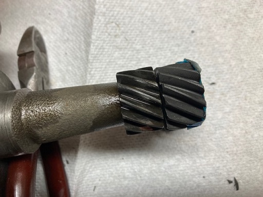

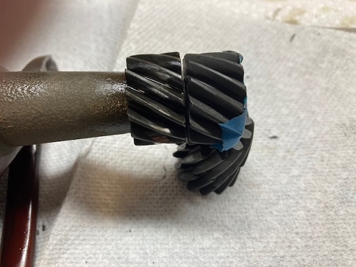

Shown below is the oil pump drive gear from the 83 D150 and setting next to it is a new never ran oil pump drive gear.
The pump is a D Dutra ported pump and the gear that came installed on it is one of Doug's hardened gears.
This pump has a few miles short of 50K miles on it and it was running against the helical drive in the OE 83 D150 cam shaft.
When I had that cam shaft re ground it already had 100K miles on it prior to the regrind so the cam shaft drive has around 150 K miles on it.
The oil pump gear has obvious shinny spots where the two gears meshed together but from my visual observation and visual comparison to a new un used gear the oil pump drive gears shows minimal wear. Hopefully it stays that way running against the NOS Mopar Performance cam shaft
