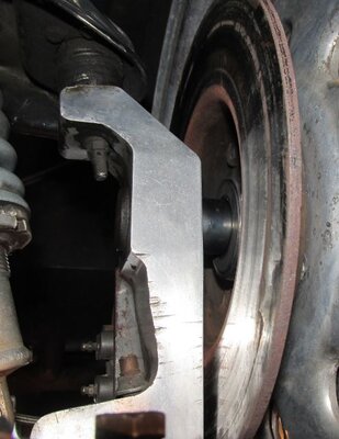

Many have asked about the spindle mounts, well just one really...
Here is the spindle on the front end.
You can see the axle shaft going into the back of the wheel.
And then the wheel slips on the stub.
Inner and outer bearings are in the wheel hub.
This is an image when the Colt got to me.
I have new rotors, ball joints, polished aluminum mount, etc.

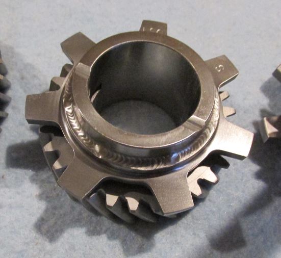

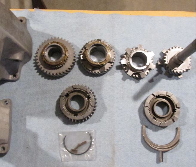

Here are a couple of images of the work.
I had my main case steel bushed for the countershaft support.
It's an all aluminum cased transmission.
2nd, 3rd and 4th are faceplated.
I have a syncro for 1st.
