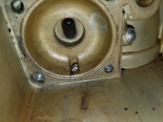

recently had a carb issue on my 65 cuda. Would crank and crank but not fire. Add fuel directly into the carb with air cleaner removed and the engine runs fine. Ordered the carb kit from http://www.daytonaparts.com (thanks SlantSixDan) and while getting ready to install it found that an opening in the bottom of the bowl was "plugged" with a pin and epoxy on the outside? Pic attached, See 6:00 position).
Is this a common occurrence with these carbs? is there a better way to patch this hole? Braze maybe? Set screw?
Thanks!
PostPosted: Mon Dec 16, 2019 11:51 am
That hole isn't meant to be plugged. It's supposed to be there, and open. That's the breather hole for the back side of the accelerator pump diaphragm. All that passes through it is air.

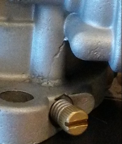

As I've seen in this thread remanufactured carbs are usually a step in the wrong direction, and for good reasons. The carb I have (other than the annoying leaky bowl I plan to fix with a doubled or thicker gasket )works ok for now. Considering the fact that the 1920 Holley is becoming more obsolete I'm thinking about getting one(remanufactured, for when not if mine wears out), at least I would have a shot at a diy rebuild if it doesn't work properly. The biggest concern at this point is in the picture I've attached; is it a minor casting flaw or crack? Any thoughts?
PostPosted: Thu Apr 09, 2020 6:41 pm
Crack or flaw, that carb has been sandblasted, which means the passivation coating is gone, which means it will sooner than later be a useless lump of powdery white "metal mould" corrosion.
One cannot undo the badness of "remanufacturing" by taking the carb back apart and putting a kit in it. :-(
