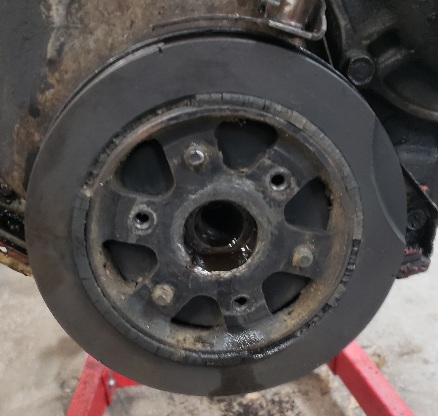

No other bolts holding this on? Not wanting to come off.
PostPosted: Thu Jan 11, 2024 6:00 pm
Posts: 9081
Use this type of puller (do not grab the outer ring) https://www.oreillyauto.com/detail/c/do ... iser?pos=5
Thread the three bolts into the hub of the balancer. Put something (bolt, piece of metal stock, etc) into the threaded hole in the crankshaft to protect the threads, and have something to push against. When you get the balancer off, I would either send it out to be rebuilt, or purchase a new one. That one is pretty well shot. The rubber is coming apart.

Thanks! I would not have thought about rebuilding or replacing the harmonic balancer.
I have a puller and it's off. It just needed a bit more torque.

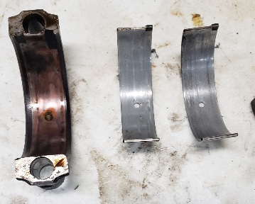

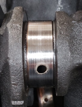

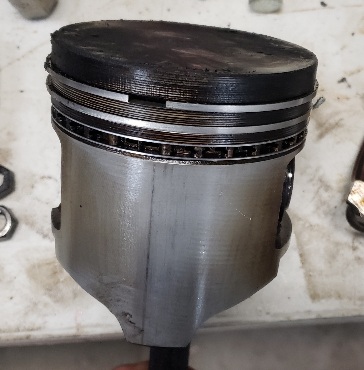

Pictures of the #1 connecting rod bearings and piston. How does everything look? Crank measures 2.190, book says 2.1875. Maybe my mic is off, it's 20 years since a certification.

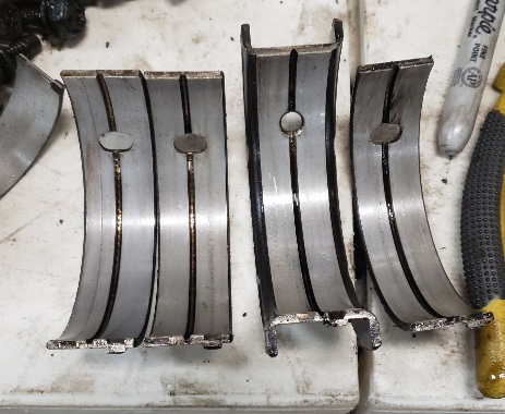

Didn't stamp them with numbers. Used an auto center punch and made dots 1 to 6. Got everything out of the block. Used an egg crate for the lifters. Got the idea here.
Picture of the main bearings.

Measured the main crank bearings at 2.190, 2.1875 is max in the SM. Maybe my mic is a bit off. The connecting rods checked a little big as well. I'm going to pull the valves tomorrow and check the head. Plan to haul it all to Midwest machine in Tulsa Monday.
I talked to the main guy there today. He mentioned they did a bunch of slants back in the day for Southwestern Bell. He wasn't familiar with milling .1 off the head/block though.
So do I have them order pistons? There is a ridge on some of the cylinders so it most likely needs bored.
Anything else I should look at?
