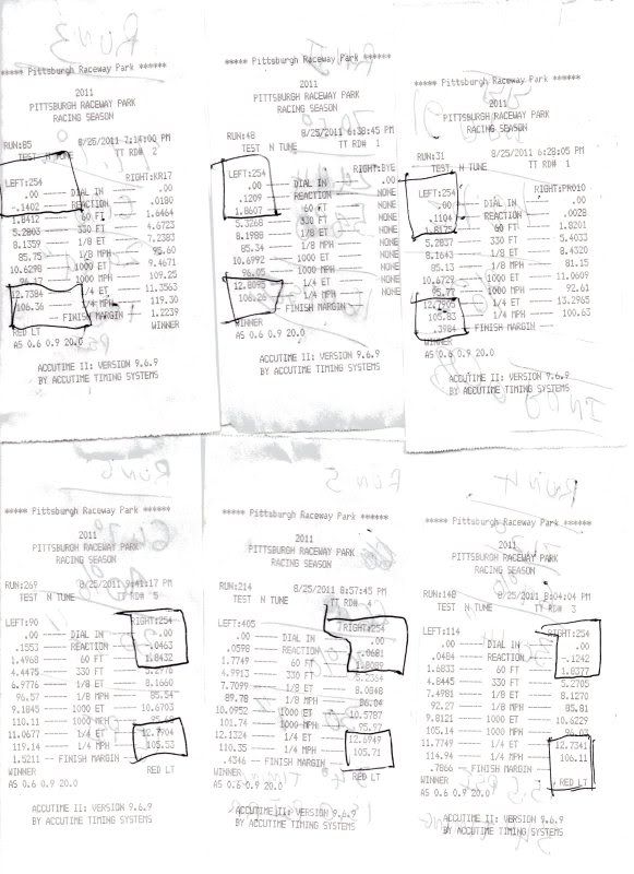

Well after fiddling with the timing a bit more My engine seems to like 34*
And with slightly worse air than 2 weeks ago (About .25" of mercury Less on my barometer)
I was able to set at least 4 new personal best records. (not all on the same Run)
1.80 60'
8.08 1/8th
12.69 1/4
106.xx 1/4 MPH
I will have to scan and post the Timeslips a bit later.
CLICKY TO WATCH VIDEO OF THE 12.69 RUN! Against another gold 4 door mopar :-)
PostPosted: Fri Aug 26, 2011 4:44 am
Posts: 17475

 Post subject: Timeslips From 8-25-11
PostPosted: Mon Aug 29, 2011 2:02 pm
Posts: 10268
Thanks for the video Greg! Before I knew what I was doing I was yelling at the screen. My wife had to check on me to see if I was alright. 12:50's before ya know it!!!!!!! :D
Wayne, I dont Know what to say Hopefully you just got a bit of slant sickness!
:D
Here are the timeslips with 4 new Personal Best Times on them ! YAY!

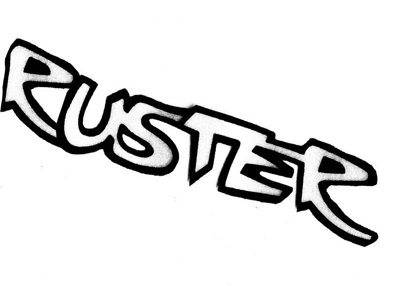

Also in the Works is a graphic Treatment for the sides of the car - Taking the 70's duster Script and Copying the "R" at the end of duster and adding it to the beginning in place of the "D" it will be a true 1968 Plymouth RUSTER!.

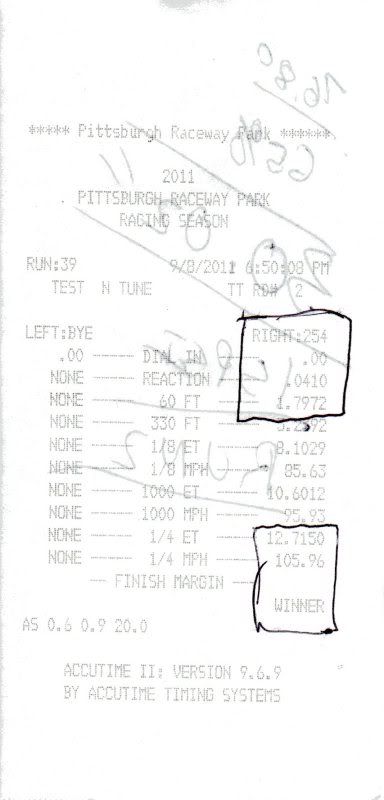

I visited TNT again this week, and the car Runs pretty consistient in the 12.70-12.78 Range and Also 1.8X 60' Times.. At either 105 0r 106 MPH.
I did Best My previous 60' Time of 1.80 now it's 1.79..
Also I found the Timesilps From the First 4 runs with Ruster Back in 2009.. With the Stock 1 BBL Slant! :-)
Ruster is In the Right lane with a sloooooooooow 19.1-19.3 Times

Well I finally Got the Graphics For Ruster Complete...
I need to either get an LCD Projector or Copy it onto an overead Transparency and then Project it on the door of ruster and Start Tracing & Painting..... I will Not have this done For clay city... But next spring should be a good date for this Modification..
