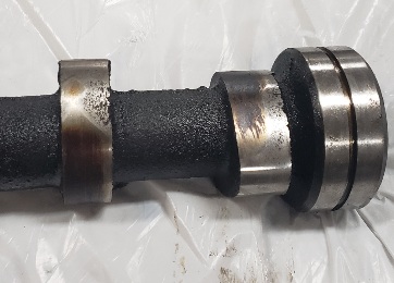

Questions on reusing the cam. My brother mentioned mic ing the cam lobes and comparing them to each other. What other things to check? Do I polish up the lobes a little? Just get a regrind from Oregon Cams?

Pictures of some lobes and the fuel pump lobe. Maybe this is beyond regrind?

Yeah that is pretty ugly.... Especially what I see in the top pic

The fuel pump didn't put out much. I now know why.

Talk with Ken at Oregon Cams, they can weld up worn fuel pump lobes.
Don’t know if yours is repairable, Ken would know.

I sent the pictures to Oregon Cams. Thanks.

Going with Oregon Cams. Welding up the fuel pump lobe.
