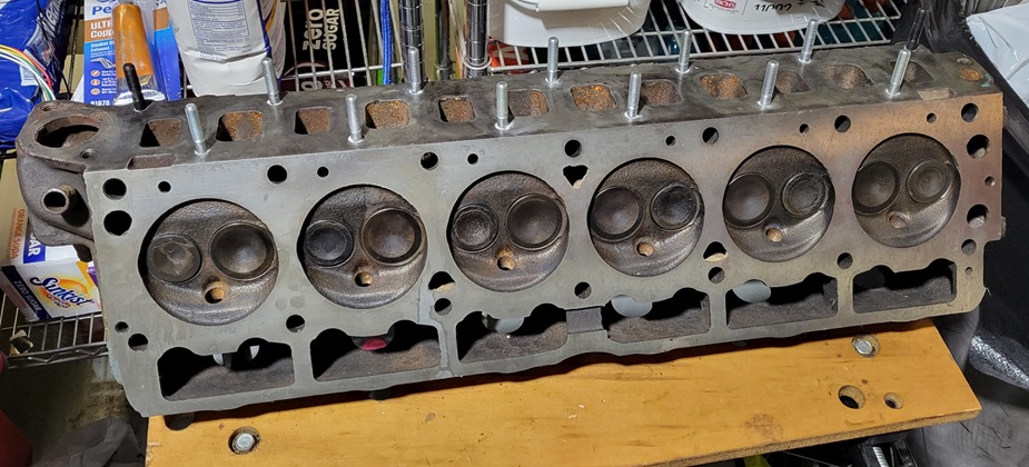

Got all the valve stem seals done and the new manifold studs installed. That's all the progress I made today. Too stuffed with Thanksgiving dinner to do anything other than sit this evening. The Remflex gaskets arrived yesterday though. Days early. They weren't forecast until tomorrow.
I had forgotten but I really need to clean up the spark plug tubes. They're really cruddy.

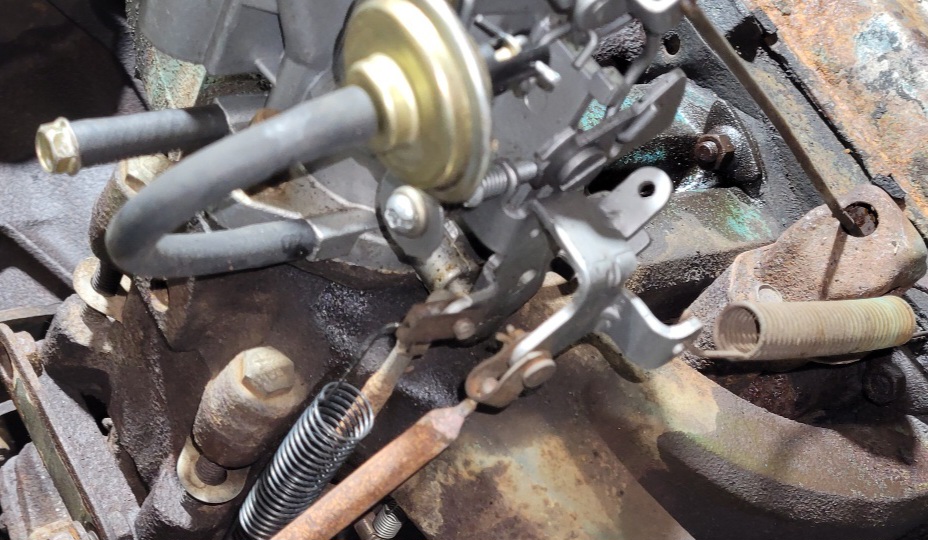

I've been searching for the conical washer for the top center stud I thought I'd misplaced. But then I was looking at a photo I'd taken of the carb linkages for reference and see someone before me had put a triangle washer in that spot. Trying to decide if I delay the project further for the proper washer or just reuse that one.
What does the brain trust here think about just going back with the washer there as pictured?

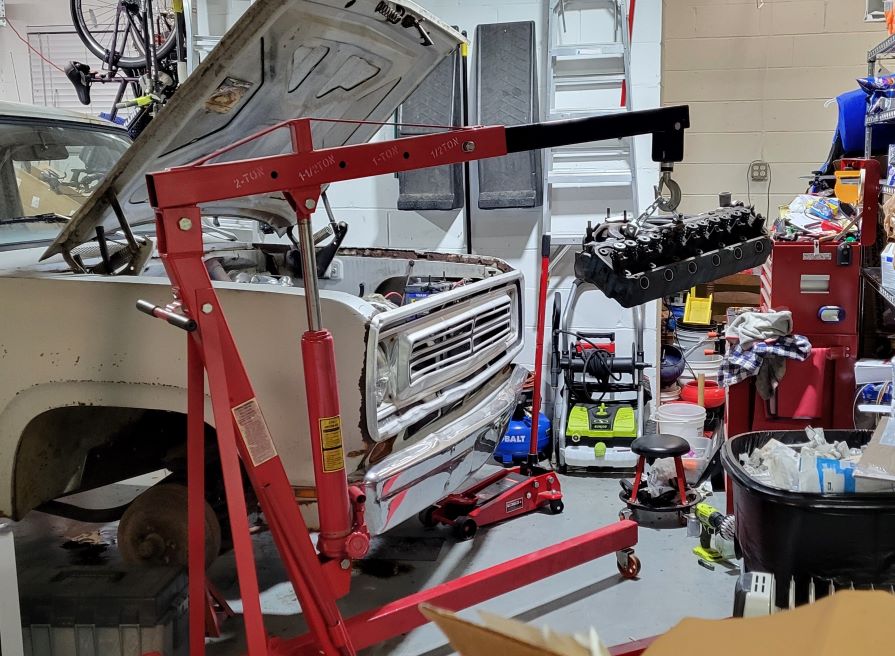

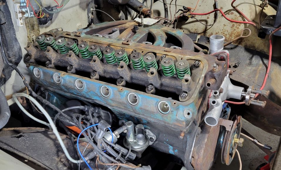

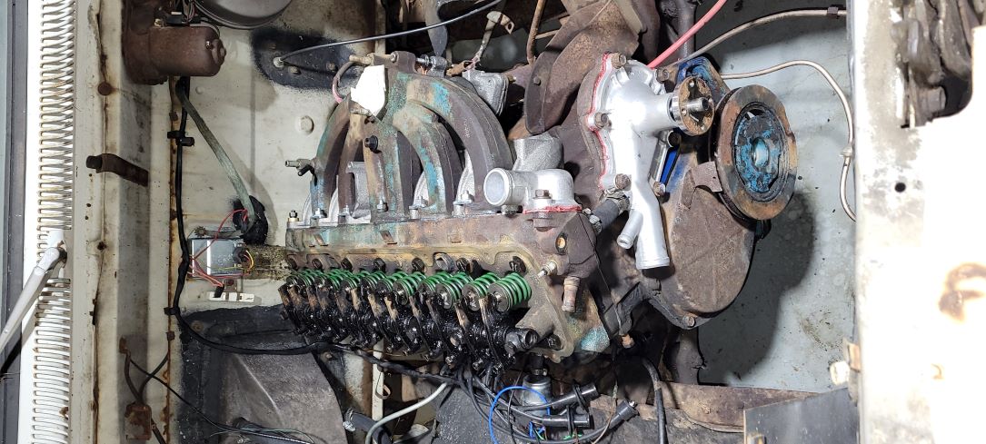

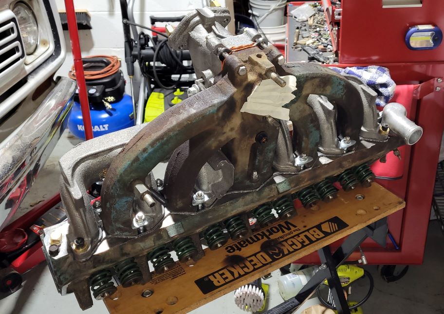

Well, bother. After going to all the trouble to chase the manifold stud threads, seal them with PTFE, bench assemble the manifolds to head and then to shop crane antics to get it that assembly in it runs BUT......I have multiple manifold studs leaking. So now I get to do an R&R on the manifolds and their studs in the truck anyway. Something I was hoping to avoid since I'm hobbit sized so have to either stand on a box or just crawl up into the engine bay. Either way involves lots of bending of my old back. I don't know if the PTFE has failed to seal due to age or if it simply isn't up to the task of those threads.
PostPosted: Sat Dec 28, 2024 7:43 am
Posts: 9500
I generally use thread tape( Which should be enough, alone) and then give it a dab of teflon paste. It acts as a sealant and lubricates as it gets tightened. Sorry you have to redo this job.
PostPosted: Sat Dec 28, 2024 8:35 am
Posts: 10410
I recently had the same issue.
Once the threads are new and clean they do not seal as well in my findings.
The ones that leaked a bit needed a lot of thread tape and pipe dope. I did finally get them to stop and seal.
Once a bit of the internal cooling system junk and corrosion sets in that will stop the leaks also.
Making sure the studs are fully seated in the head helps with this problem.
PostPosted: Sat Dec 28, 2024 8:53 am
Posts: 9500
That seems odd? :D
I have been chasing almost all the threads in everything I assemble. It makes my life much easier in the future when I take it apart. :D :D
PostPosted: Sat Dec 28, 2024 10:18 am
Posts: 9081
Those studs have a "shank" in the middle. I make sure the threads are clean (but not loose). You don't want the stud to be sloppy on the threads. Then I use "lock tite" thread sealant (545 purple) on the stud. Install the stud in the head till it is "snug", against the shank. Let the sealant cure before disturbing the stud. I have had several leakers both with small blocks, and slant sixes, until I started doing them this way.
PostPosted: Sat Dec 28, 2024 1:39 pm
Posts: 25072
It's not the appropriate (or specified) material for the job. PTFE sealant is appropriate for pipe-thread joints.
Clean the studs and head holes thoroughly, and use Loctite 542 or 592 on the head ends of the studs.
