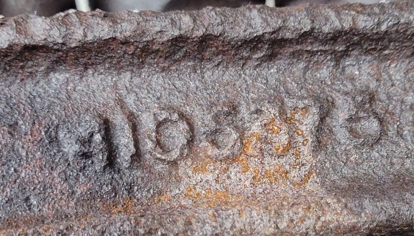

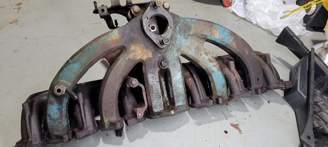

Thanks for all that helpful info. My exhaust manifold looks exactly like that one from Dorman you recommend in another thread so maybe it isn't original? The little cup for the thermostat isn't open to the exhaust stream. I've posted the numbers cast into it.

PostPosted: Wed Nov 06, 2024 10:19 am
Posts: 25072
That's a '73-up manifold set (intake + exhaust), so you avoid the choke-cup problems mentioned. Does the heat control valve work? You'd still want the № 1231 electric choke.

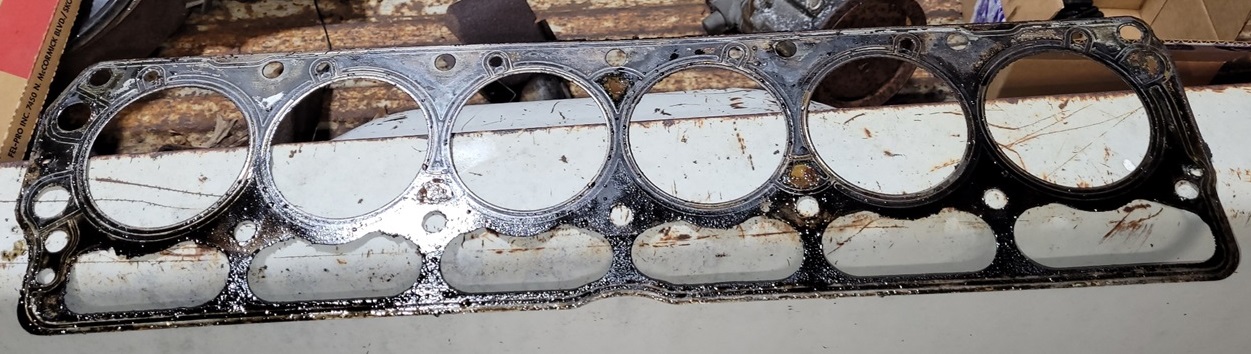

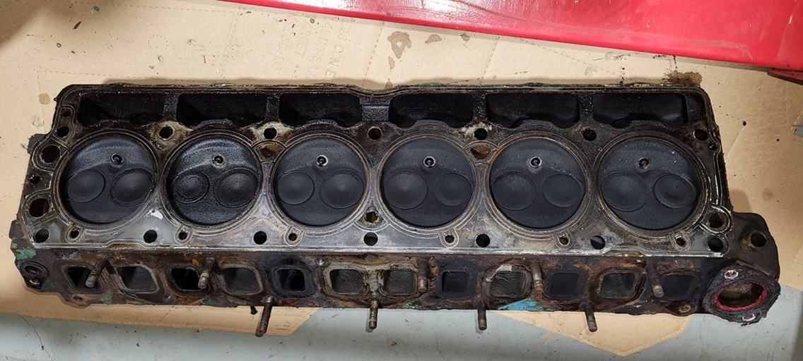

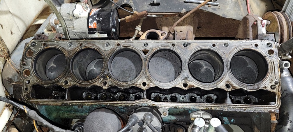

Well someone has been here before. I don't believe it left the factory with a MLS head gasket.

PostPosted: Thu Nov 07, 2024 7:31 pm
Posts: 10410
Maybe, maybe not.
They left the factory with a single layer steel gasket.
Look for a pentastar in the middle.
If it was replaced before it would likely be a composite napa, mahle , fel-pro or other aftermarket gasket.
Yours looks original to me.
