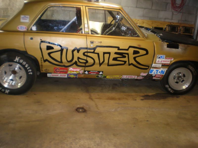

Well Since My Runner up in Clay city Ruster Has pretty much Been sitting on the trailer until this week..

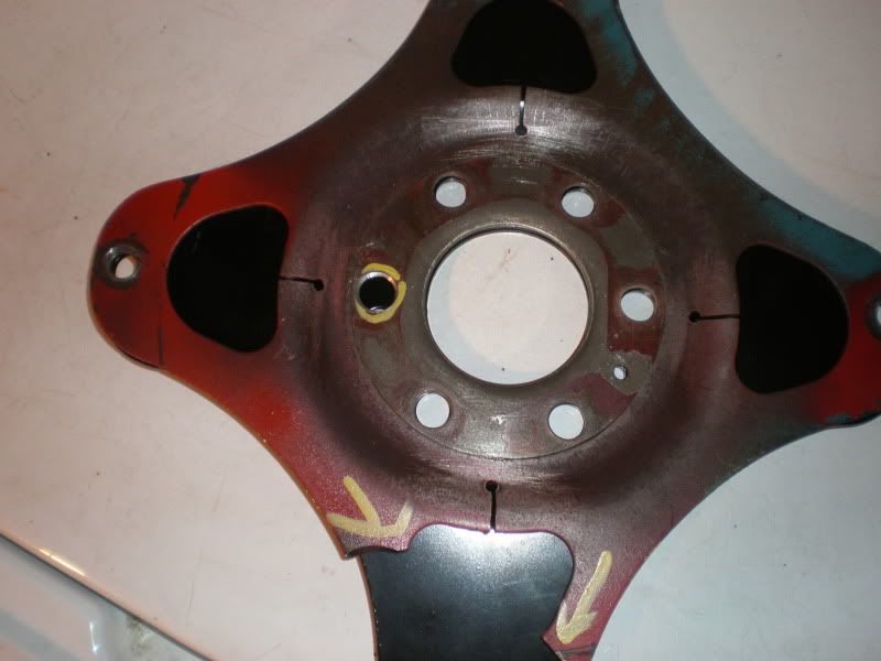

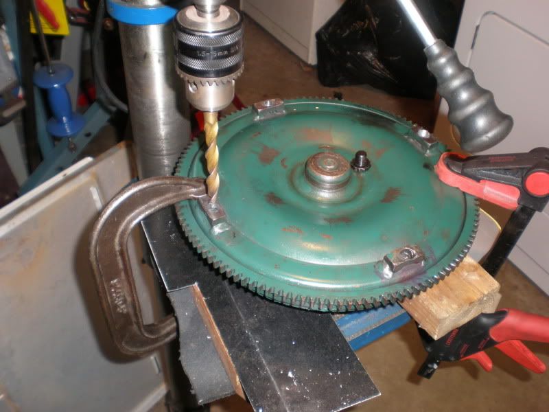

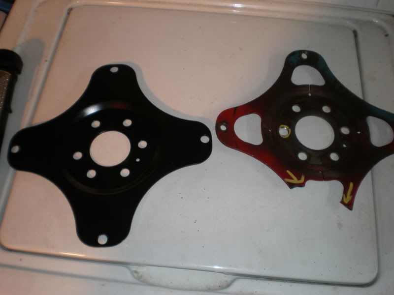

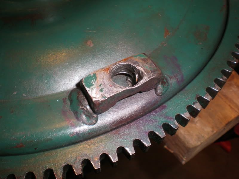

I got to move it into the garage.. Finished hand Painting the Graphics, Nd began work on My aquired 8" converter.. I was used and had some boogered up threads so I am drilling the flexplate mounting holes on the converter out for some 7/16-20 Helicoils.. and Adding weld where needed to beef up the mounting points.
Got me some 7/16 ARP Bolts and another LA -904 SFI Flexplate that I will drill and Make into an SFI Slant 6 904 Flexplate.
Future Winter Plans include More Stealthy Aero Junk... Cutting, Cutting, cutting.. I am going to attempt to do what I can with a budget of $0 this winter... saving for Next summer.
Pics:
Ruster Graphics Complete:
Converter Sugery:
Just a bit out of round :shock:
Using My old broken stock flexplate as a Guide
Turning the 318 Flexplate into a Slant 6 one.

you know those heli coils will fail..
1 in 4 chances @ the wrong time
