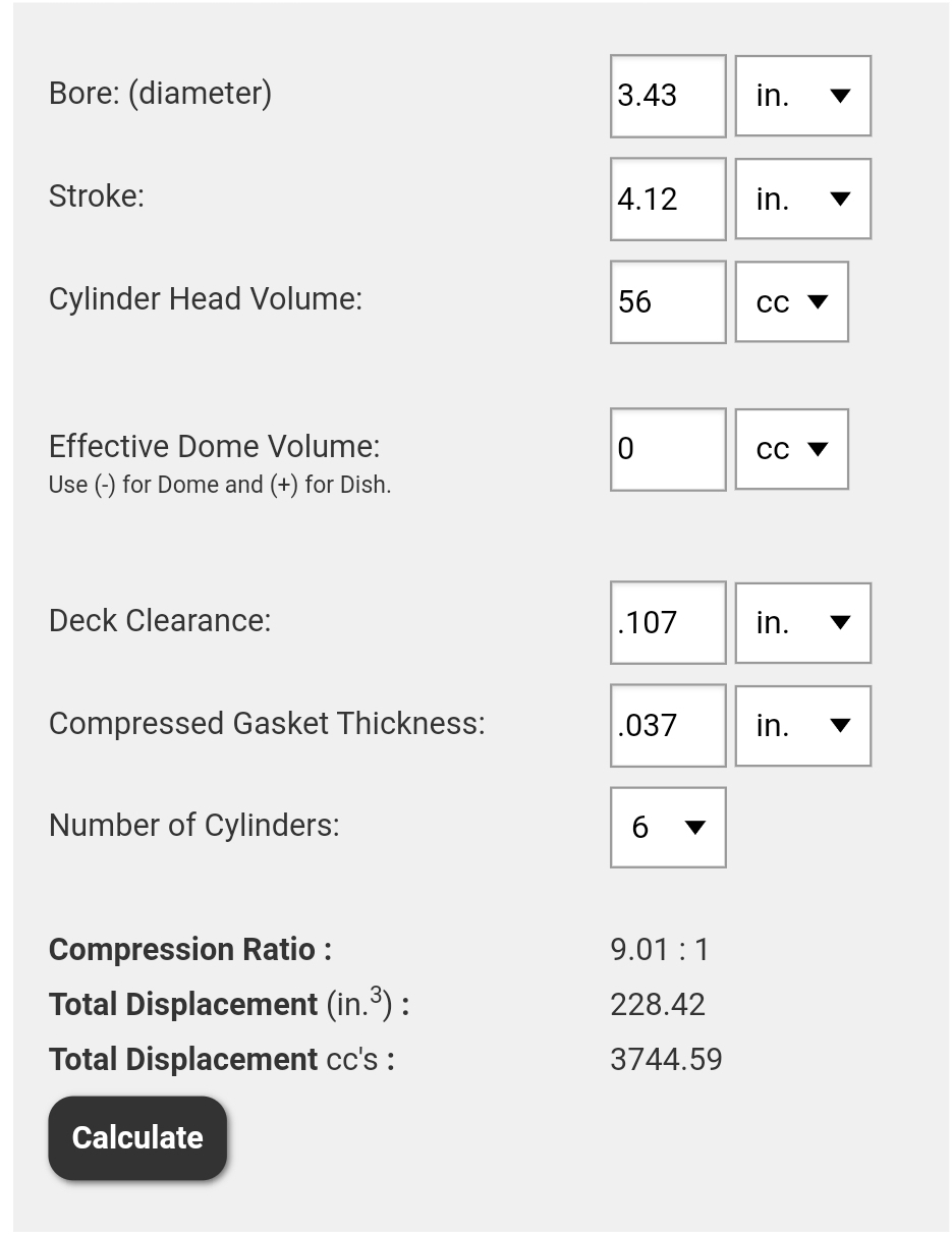

Not sure what changed but refigured just now and get .05 off the block for 9 to 1. Assuming I go .03 over on the pistons. If material is removed from the head the block will be decked less. I found some older threads here about pushrod length. Still searching and reading. I'm tempted to stay stock. :shock:

Was putting this info in a different calculator the other day. Don't think I was getting 9.4. .09 deck height would be. 067 off the block.

I would be careful trying to go over 9-1 CR on a street engine, with a very mild cam. I have a 170 engine with 9.5-1 CR and the mildest MP cam. I had a hell of a time tuning, to prevent detonation with less than 93 octane.

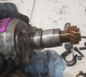

Forgot to add the distributor picture. The o ring seems, small. Should there be a better seal here?

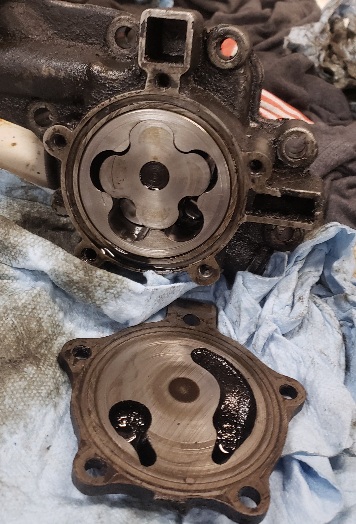

The oil pump checks good, diameter and thickness. Lobe to lobe is less than. 01. SM says .014 max. But there are gouges. I'd like to keep this one. Gouges too bad?

Resolution is bad. I'll upload a better picture in a bit.
PostPosted: Mon Feb 05, 2024 4:39 pm
Posts: 3292
That's just the cover? Know anyone with a decent size belt sander? That cover can be resurfaced
PostPosted: Mon Feb 05, 2024 4:59 pm
Posts: 109
Location: Oklahoma
Car Model: 1983 Dodge D150
I have a belt sander. Was thinking sand paper on a flat surface.
There are gouges in the center gear. Wonder if that's why the lobe to lobe clearance is about .005. I will try to get the drive gear off and inspect the gear lobes more closely.

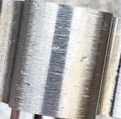

Overcast today, great for taking pictures, and I got the oil pump gear out. Would you reuse this?

PostPosted: Wed Feb 07, 2024 4:23 pm
Posts: 3292
I've seen parts that have sat a while stained like that. Can you catch a fingernail on any of it? It's probably fine. I don't see gouging and/or scoring that would scare me away. Somewhere around here I have a new (old) melling oil pump rebuild kit for the stock oil pump.
I saw one recently on feebay but went past it cuz I wasn't looking for one then.
I will say that a couple of years ago I went looking for the o ring / gasket for the cover and for the relief valve , as the ones in that kit I have was folded over in the box and being as old as dirt it wouldn't smooth out, and I got the last few in the pipeline at both auto zone and O'Reilly's. Neither were overnight, it took each a couple of days to get them from a father away warehouse than they usually get parts from ..
But if at all possible try to rebuild what you have, youre probably not gonna find an original style 6 bolt pump.

Posting a picture from the above link. Yes, a fingernail will catch.
