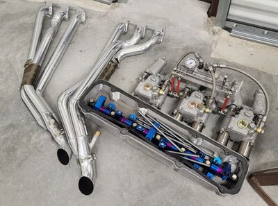

PostPosted: Wed Jan 10, 2024 4:59 pm
Posts: 2391
After the Holidays and finishing some shop wiring and lights I got some time to start.
The Autopsy has begun.

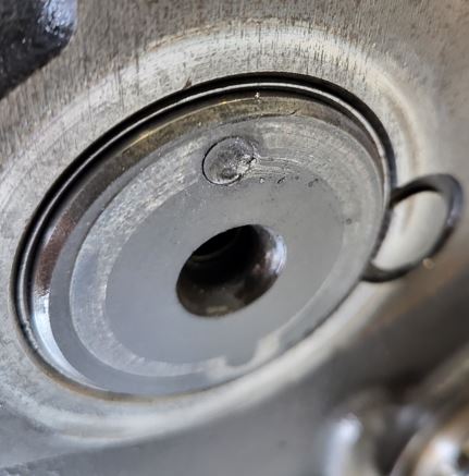

Posts: 2391
Damper galled on the crank snout.
Bugger on the inside of the Damper.
Cam dowel is sheared off clean with the cam face.
The cam button I wanted and Mark G made worked perfect, no wear but it kept the gear in place.
So, crank, cam, new damper, and some machining.

I have never seen that before? Was the damper damaged from being so tight going on?
PostPosted: Sun Jan 14, 2024 7:15 am
Posts: 2391
I am not sure Rick, but was super tight as you and I have seen putting them on.
I spent 3 days pulling it off last time but I could not get at it with the frame.
I had to use a flat metal circle with 3 bolts and turn them a 1/4 turn at a time.
But really the problem was it had galled then also.
I dressed everything as best I could and put it back on.
This time with the engine out I could use my puller.
It was hard, much harder than it should have been.
I can post the inside of the damper hub later today.
I like the one we have because of the v belt, but the tightness bothers me.
I don't see them on epay anymore.
