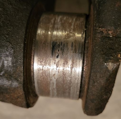

I was going through cranks the past couple of rainy days.
I have always run the big cranks, and I have another nice one I can use if we can't fix the snout on my current crank.
But!
On the advice of someone much smarter than I, I started looking at my little cranks.
I thought I had a winner till I got down to #6.
If it doesn't clean up at .030 it's going into the machine shop scrap bin!
Then I looked at another little crank.
On first glance it looked like crap.
It looked rusty, till I took a razor plate to a journal.
It was like cosmoline, but it was gunk.
Like it was dipped in a wash tank sludge.
I have no idea where I got it.
But a couple of hours later it is a standard dimension crank on rods and mains.
Winner, Winner, Chicken Dinner.
Glad I didn't throw it away.
And if I use it, the car will be a few lbs. lighter.
Now to figure out the damper issue.

Crank shop called, the "junk" crank is just that.
I will talk with them on Thursday, he said he could weld it.
Didn't say how much!

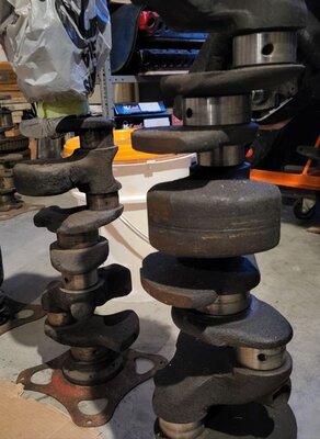

What is a 'big' crank, 'little' crank? What are you referring to?

Lou, thanks for that kind offer.
I have other cranks so no issue there.
This is the #6 journal on one of the cranks I carried to the machine shop.
I polished the snout with a high speed buffing wheel.
Pressed a stock damper on and pulled off.
MUCH easier than the ROMAC.

Here is a picture of what I call "Big" and "Little" cranks.
Both are early small converter/flywheel register flanges.

One is probably a pre-1962 (3) Crank.
I bet engineers figured that they could make a reliable engine with much less Iron in their forgings and still get a reliable 145 HP.
PostPosted: Wed Jan 31, 2024 8:29 am
Posts: 2664
They were called Truck cranks when I was a kid.
