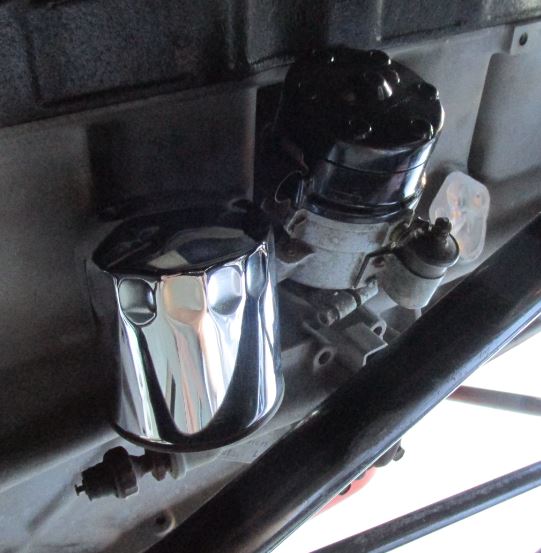

PostPosted: Sat May 16, 2020 3:54 pm
Posts: 2701
Now you guys have me thinking, and that hurts.

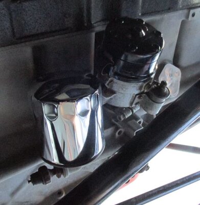

I will cut the plate and leave the pump cut-out off for now.
Dist fits, however I can't get the oil pump in or out, it hits the frame.
More thinking...

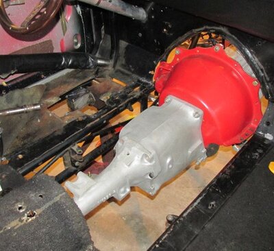

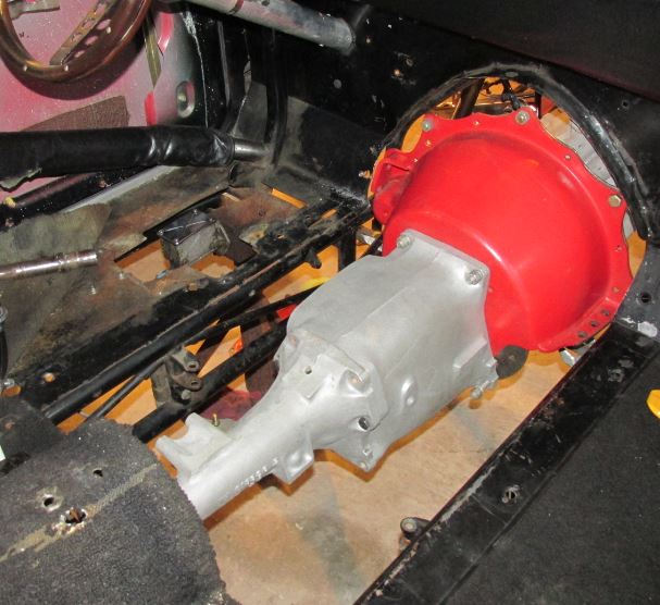

So here is the latest progress, man this part is fun!
Trans in place, block plate in the correct location, 30 degree tilt done.

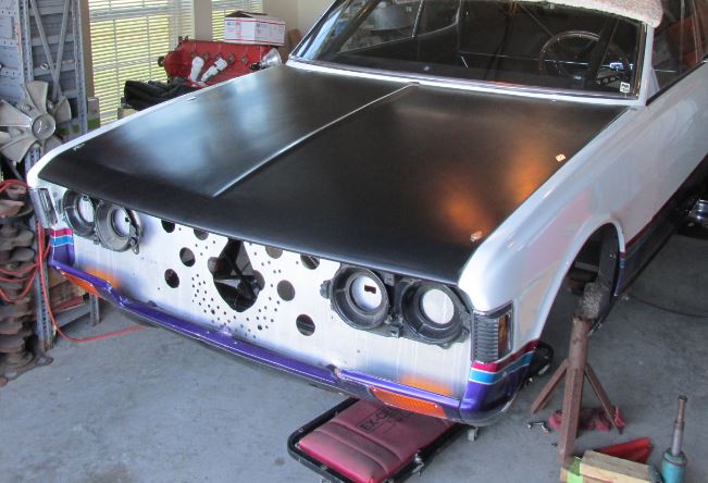

Figured out if I kick the front of the motor over a couple of inches, I could get the pump in. So I put all the stuff on the motor, put the front end back on with the hood and I have a 1/4 inch between the hood and the front breather. So I used the Offy valve cover and it has a pretty high standpipe. So if I cut a 1/4 inch off of that I will have plenty of clearance. First picture is everything installed and hood on, it fits! Now for the Headers....

Posts: 1464
Will tilting the engine have much effect on the clutch and transmission linkage?
PostPosted: Mon May 18, 2020 9:38 am
Posts: 2701
Badvert, the engine is at the 30 degree tilt as designed. The bellhousing is square with the frame, so all that stuff is right were it should be. The transmission rear mount is square to the rear crossmember. I am going to use a hydraulic throw-out bearing because I don't want to fabricate a bunch of linkage and rods in the close space I have.
Is that what you were asking?

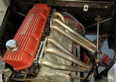

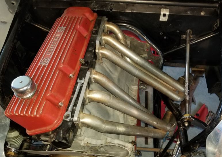

Here's a picture of the headers Jeff Long built for my Daytona. You may end up doing something similar.

PostPosted: Sat May 30, 2020 7:19 pm
Posts: 2701

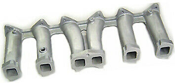

Mr. Burns sent me his last set of NA headers to see how they might fit.
The good news is except for a couple of spots they fit pretty well.
The bad news is they don't fit the Clifford Weber intake very well.
At least 4 tubes would have to be massaged quite a bit.
So thinking about getting the manifold from OZ and using that one.
It looks like the runners are a lot straighter.
Thoughts?

PostPosted: Sat May 30, 2020 7:47 pm
Posts: 14908
I still vote for building a set that fit like you want. Pay once, cry once, done. :mrgreen:
PostPosted: Sun May 31, 2020 4:29 am
Posts: 9438
That is what I am running Stan. They do give you a little more room. They are 1.5" longer I think. Mine had to be massage quite a bit. Cross section was quite a bit smaller than the Clifford. Casting was off pretty good as well. Runners were not all level with each other when you laid a straight edge across them. Good news was there was plenty of meat to open them up and straighten them out. .
