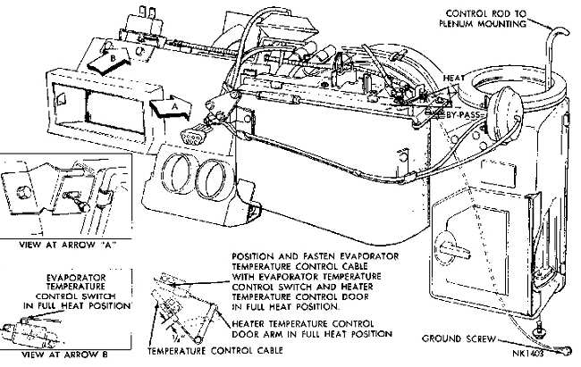

The entire heater box should pull-down if you remove the 4 fan motor nuts, the hose end outlet cover and the plenum box control rod "hook". This hook is a long rod with a bolt at the bottom of the box.
It is a good idea to open the vent door and oil the bolt threads before unscrewing. This bolt has to be loosened a lot before you can get it off the sheetmetal lip it "hooks".
As for that gloove box, you may be able to squeeze it down some and work it out forward or get it out the back once the heater box drops down some.
Here is a look at the AC heater box for a view of the hook.
