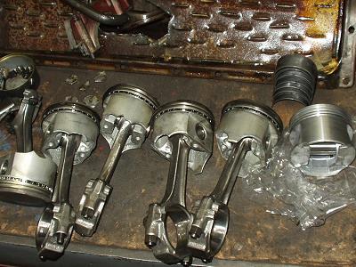

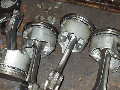

That would change my plans with my 209 "low block" engine, that currently sitting in pieces... with a bunch of broken 3.500 Vega cast pistons. The big problem for me is that the small end of the con rods are at the GM .927 size.
