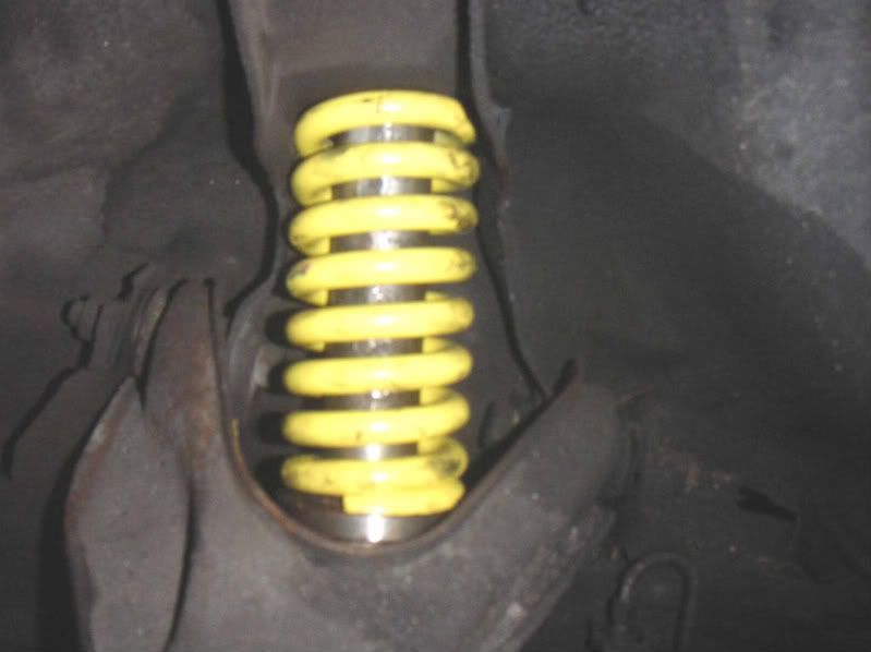

this is how my front suspension is currently setup - using spring over hydraulic cylinder mounted where the shock absorbers would have gone - and the torson bars have the ajuster ears taken off. wish I still had them tho. that way I could set a little tension with them and not slam the crossmember on the ground so violently :O

so im thinking with my basic garage tool setup I should probably be able to remove most the suspension components that id need to for replacing all of the front bushings ? - with maby the exeption of a wedge spanner fork that is sometimes used to hammer in and spread apart pieces ?
the car came to me with the front suspension setup like that.
the hydraulic cylinders up front have 10" of extension / compression to them - so when I hit the switch to dump all the hydraulic fluid back to the tank the front end goes all the way down until the front crossmember is actually resting on the ground. when the hydraulic cylinders are fully pumped up with fluid - I have 9.5" between my front crossmember and the ground. - so my ride height is infinately ajustable at the flick of a switch mounted in the interior of the car - and those yellow coil springs allow for a small amount of suspension movment on top of the hydraulic cylinders - as that oil does not compress or ride nice like cars with air bag suspensions do.
the thing I would change is that I would of put the torson bar ajusters back on and just set them to "catch" the car if you will when its realley low to the ground as those little coil springs up front are pretty soft -and I bet the ride quality could greatly benifit from having some extra spring tension up front.

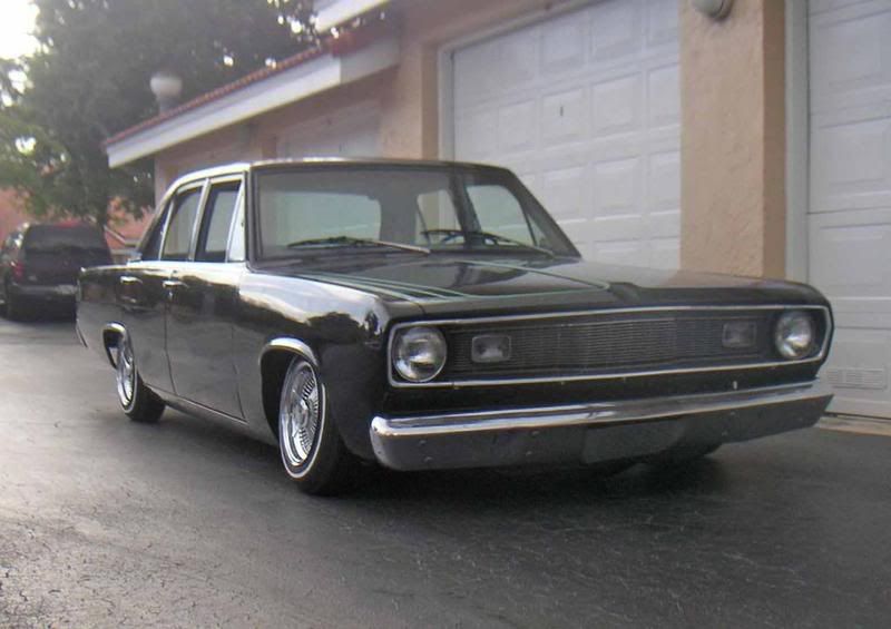

fully raised front and rear
fully dumped down front and rear

Ah, I see. The problem, as radarsonwheels mentioned, is that the upper shock mounts are not designed to bear the full weight of the car at all times. In order to use these shocks properly, the upper shock mounts MUST be reinforced, as they are in aftermarket coil over conversions like this:
http://tinyurl.com/y2bzsc7
You could fabricate these reinforcements yourself, this link is just an example of what I'm talking about. Granted, this suspension is a different intended use than yours, but the principle is the same.
