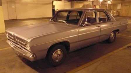

Before

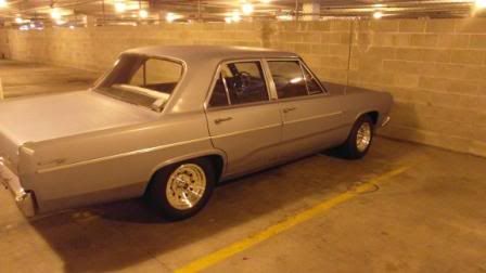

After
Thanks for the help.
The professionals at ALL the tire places in Bellingham were helpless. If anybody else tackles this project, it's best to do all your own thinking.
