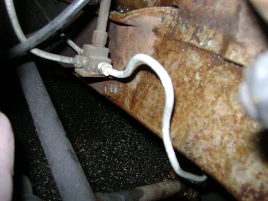

Sorry for the delay, car was covered in ICE last couple of days. Just shot this pic at work! Hope this helps.-Dan
1964 Dart GT
PostPosted: Tue Mar 04, 2014 11:48 am
Posts: 852
Location: Los Angeles, CA
Thanks. Your tee-block is not the same one as the Inline Tube block you pointed at. There's an extra port on yours, compared to the one they shipped me. The orientation of your block on the mounting strap is also different, which means the mounting strap is different than mine.
I've called Inline Tube and for whatever reason, my block/bracket is their BLK 243, mounted on a long L-bracket. They call it "1965-66 A, B, C-body Distribution Block - Polara / Dart / Coronet / Fury / Belvedere".
Problem solved, moving on, waiting a few more days to get what I need.
PostPosted: Tue Mar 04, 2014 12:44 pm
Posts: 1315
Location: TEXAS
:? BLK241 is what I ordered from Inline Tube, it was listed as a 5-port, but was actually 6 with a threaded plug! Don't know why they would change it? It works fine as is. Hope you get it straightened out.-Dan
1964 Dart GT

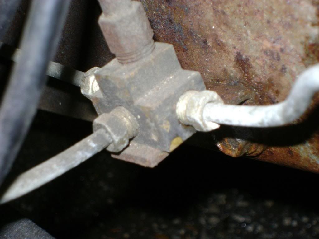

There's a 3-way junction just below my single-pot MC. Two splits feed the front brakes, and one split feeds the rear. Do people usually just plug the rear split on that junction and mate/flare a new line from the rear directly up to the "R" output on the MC? Is there any better way to do this?
Yes, that's an acceptable, safe, and very quick way to take care of a hydraulic system if you have 4 drum brakes. See several pictures and a nice long-winded story here.
As others have pointed out, there are more elegant ways, which provide more flexibility. :)
