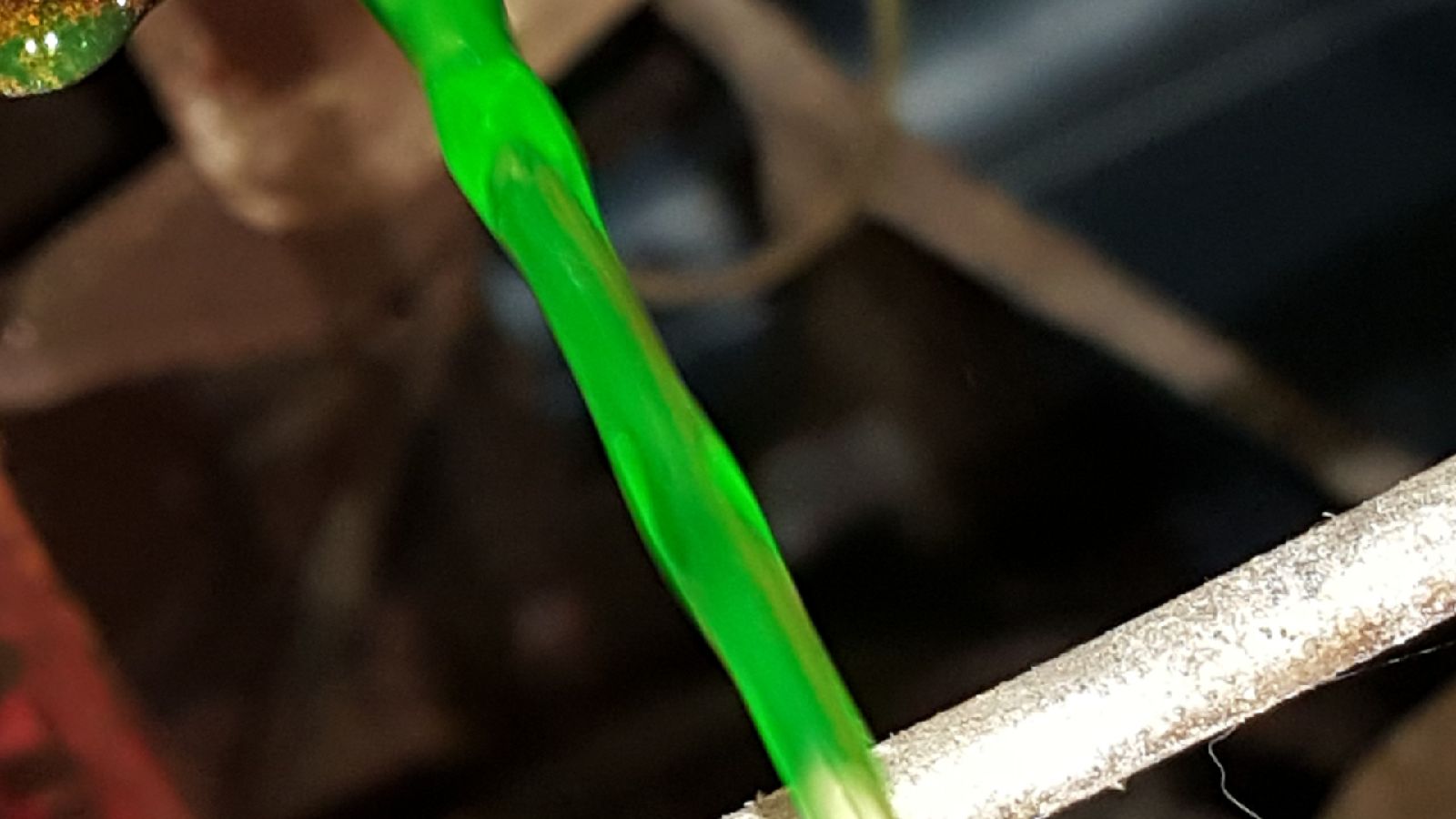

Antifreeze wasn't good enough to get through this past winter. Been in the garage for 3 or 4 years and decided that was long enough and started moving Hoopty around in preparation of a minor resurrection.. saw a little antifreeze and dismissed it at first. Bad deal.. cracked block. DOH

Looks can be deceiving... I guess it's possible that the antifreeze wasn't diluted enough. I'll test tonight.
Looking at motors and reminding myself that I don't HAVE to replace the cam with something lumpy. Just stick to the basics Dan.. Dan, hey DAAANNN! Basics
