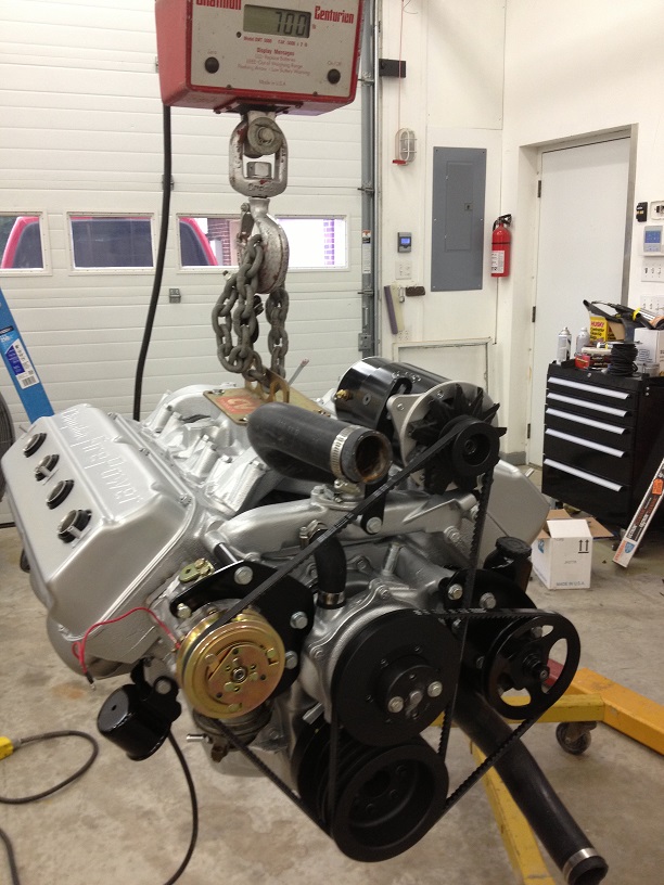

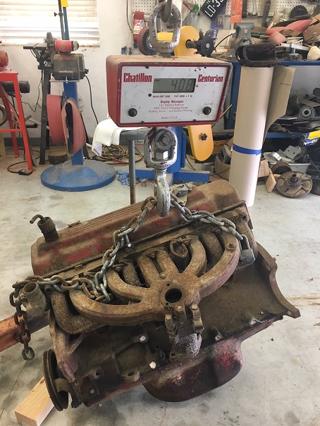

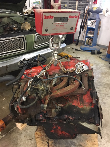

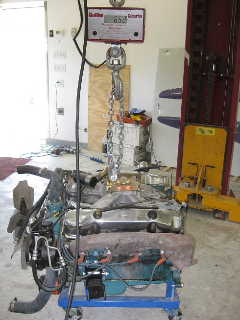

No, not the classic song by The Band but rather some pics of car parts hanging on my trusty Centurion scale

Excellent. What year is the 225 engine, 67?

Time to go 170 to save ~ 100# over the front axle :D :D :D

It's a 68 Valiant. When I removed the engine Saturday, it was the first time it had been out, It had a good run, lol.
It had all the signs of an engine that had spent a lot of its life on the cruddy oils that existed for many decades. But also of someone using non-detergent motor oil. There was a solid crust of hard dirt on the bottom of the pan. Not oily sludge, but almost-dry crud. The entire pickup was under the dirt, so whatever oil it was getting was making its way through a little hole that found its way in the crud.

The 170 is missing a lot of stuff, water pump, carb, accessories, etc. I don't think the 170 would be that much lighter than an equal 225.

The 170 is missing the alternator and associated brackets. It's also missing the ignition coil and water pump/pulley and the motor mounts and some smaller brackets like the PS mount and throttle bracket. And carb.
But, it has a lighter crank and 1" less of cast iron deck. Plus (I believe) shorter rods.
When I strip the 225 down, I'll try to make it equal the 170 in terms of 'stuff' and we'll see what the difference is.

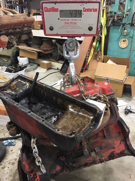

OK....here is the 225 in the same state of dress as the 170. There are tiny differences, like the throttle bracket is still on the 225, but they're essentially the same.
434lbs - 225
408lbs -170
I actually thought the difference would be more. As for bolted-on stuff, the big offender was the alternator (and cast iron bracket). I didn't weigh it but it sure had some heft.

The cast iron alternator mount weighs in at 2.8 lbs.
My 65 alternator weighed 13 lbs.
I did manage to shave the factory bracket down 1.15 lbs., but still heavy for what it does.
