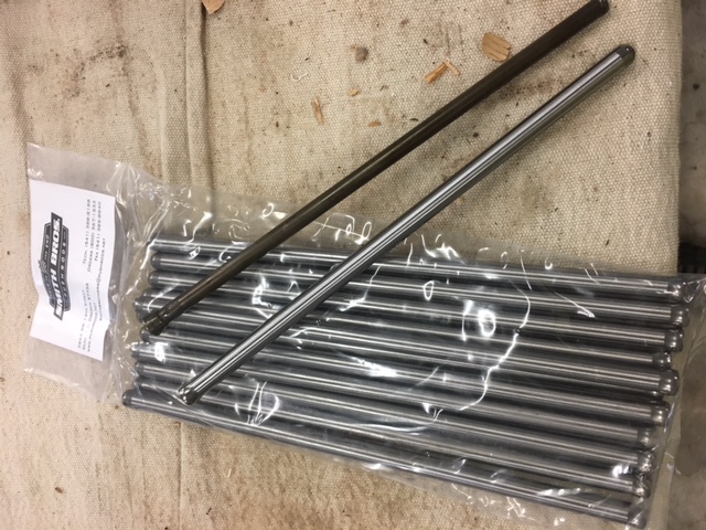

First, a sexy pic of the Smith Bros 3/8" pushrods, .100 shorter than stock....
