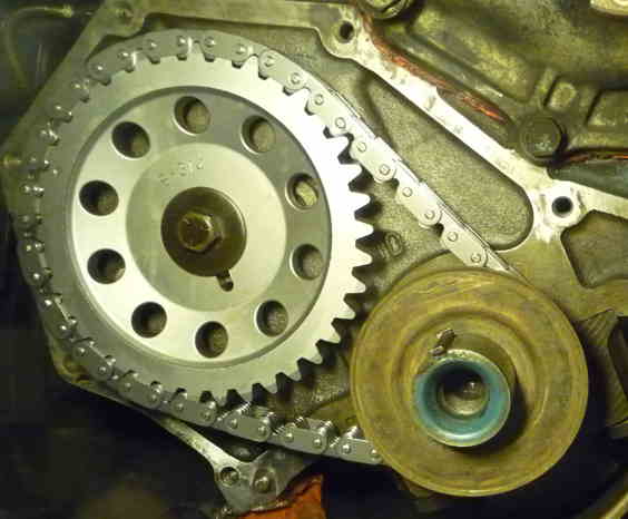

Shouldn’t be. Read many posts here and worked carefully. It’s dished out: outside edge away from the engine and sprocket/chain. Not all that obvious on this pic, but maybe this will help:

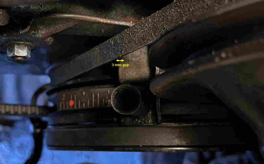

Careful visual inspection revealed only 3 mm of clearance between the timing tab bracket and inner side of the air pump belt:
air pump belt too close to timing tab annotated SL6.jpg [ 24.88 KiB | Viewed 4397 times ]
Removing the air pump belt and fastening it safely out of the way resulted in a wholly normal engine sound: loud noise wholly gone.

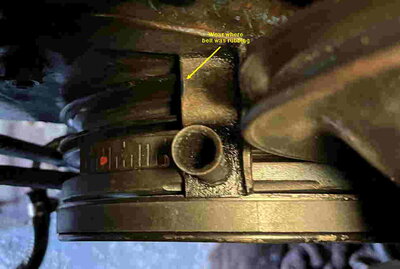

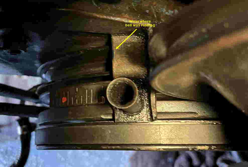

Noticed there has been some wear between that belt and the bracket:

The timing cover had been slightly offset, evidenced by asymmetrical wear on the front and the crankshaft not being centered in the seal before cover removal. I don’t remember what direction it was. When i reinstalled the cover, i was careful to center it, to hopefully minimize leakage.
Noticed that the timing tab was not quite on its positioning indentation pin on the cover. I had not touched it: it remained exactly where it had been since i got the van. Marked the tab’s position very carefully with tape on the vibration damper, then experimented with adjusting the tab to the index/positioning pin. It only shifted about 1/2°, but felt like it fit correctly, and the tab itself was more evenly spaced from the vibration damper along its length. Unfortunately that only bought me maybe 1 mm more clearance if any at all.
Experimented with trying to move the idler pulley as far towards the passenger side as possible, to try and get more of a gap between the belt and bracket. Did not really get any more.
What sort of gap is normal between this belt and bracket?

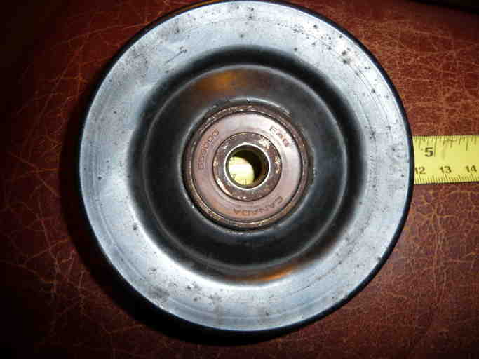

Here’s the pulley in question:
4 1/4" O.D., 1/2" center hole
This vehicle originally had air conditioning. One memorable northbound Interstate 5 trip, the air compressor, which at that point was doing nothing other than being an overweight too big idler pulley, broke 2 of its 3 mounts. Removed the belt and compressor, and drove on. (Yes i did cook at least one of the catalytic converters. That’s another story for another time.) That very same day soon as i was near a major metro area with a Dodge dealership, i dropped by the parts department and got the official idler pulley hardware for vehicles with an air pump but no air conditioning.
Seems like the bearing could be pressed out and replaced, but i’m wondering whether it would be better to seek a 4 1/2" pulley, to get a little more of a gap between the belt and the timing tab bracket. I know nothing about how easy/difficult it is to find more or less what i would think is a generic v-belt pulley of the correct size with a decent bearing.
Only as a test, i’m thinking of spraying in some high-quality lubricating oil into the bearing and remounting the pulley to find out if it can be quiet for a couple of minutes at the high idle where it has been so noisy, to verify that tor problem is indeed the pulley bearing.
Thoughts? Ideas? What would (any of) you do?

I'm having a difficult time with the prospect of that idler pulley being on there since day 1 and this issue only cropping up after the re-installation of the removed components. Did you dismantle the belt drive components related to your belt interference issue?
I get the feeling something may not have been reassembled correctly. It is difficult to see in the photos, but all of the later slants I have seen/worked on had the timing tab sticking out the driver side of the cover, so access for visual purposes would be the same. This appears to be sticking almost straight up towards the water pump. Is that the case?
To attempt to get the belt further from the timing tab, a larger pulley would certainly help; but it occurs to me that something else is off if there wasn't an issue prior.
My .02 :mrgreen:
Day 1 for the pulley was when i retrofitted it to replace a disused A/C compressor with 2 out of 3 mounts broken. The A/C was factory and long-dead from a prior owner’s front end collision. All the compressor was doing was acting like a pulley. I used the official Chrysler parts specified for the non-A/C model of my make/year, purchased new from i believe Hayward Dodge back around 1989 when parts were still available.
The timing cover has been recently off. I was very careful initially not to move the timing tab, and the cover allows very little degree of freedom—not enough as far as i can tell to materially affect the belt clearance. Once the clearance problem showed up, i noticed that the timing tab was not quite in its factory index indent on the cover. Made a minor adjustment which only altered the timing display by 1/2 degree if that, and gave a tiny bit more clearance.
This belt was adjusted (by me) much tighter after servicing (when the noise first showed up than before.
It’s facing towards the passenger side, as it has on this vehicle since i’ve had it.
My .02 :mrgreen:
~THOR~
Thank you for your thoughts. In terms of the noise, i’m still thinking pulley bearing wear, triggered by my tensioning the belt far tighter than it had been. It had been loose before and tended to slip when the engine was first started. When i looked up the part number for the pulley, which was also used in some Jeep models, there were many reports of noisy bearings and seeking replacement pulleys or bearings for them.
In terms of insufficient clearance wear near the timing tab, i think it may have been like this for a long time and i just recently noticed.

Brief follow-up: the noise was indeed the pulley bearing.
Found a Gates 38040 works. Slightly larger O.D., otherwise fits nicely. For my particular engine there is enough clearance for the larger O.D. (123 mm vs. 108 mm for the Chrysler original part), and this moves the belt slightly further away from the timing tab.
Since installing this pulley, the engine again sounds the way it always has in the past, when running correctly.
