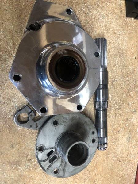

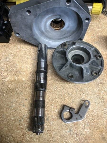

I found one for sale back in 2018 on another sight, but no info on who made it.
Said it had GM TH350 splines.

A little late but that shorty kit is the one I made for the green grenade. I sold it with a bunch of small block stuff to a guy that worked for Crower. The stock 904 shaft was cut and resplined by Mark Williams and they were reasonable on the labor.
The 904 was worthless in the dragster. You could not even think about leaving it in first gear as it would wheelie big time. Powerglide is the way to go.
4:10 gear was too much gear with a 29.5 tire in our application.
