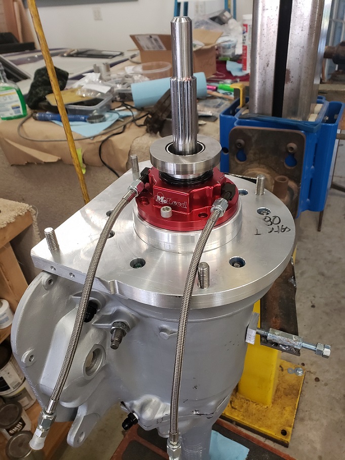

Unless I were really worried about originality, I'd never use a mechanical clutch linkage...the hydraulics work too well. They also free up space underhood. I used a McLeod in mine, you just have to buy the right part number for your trans.

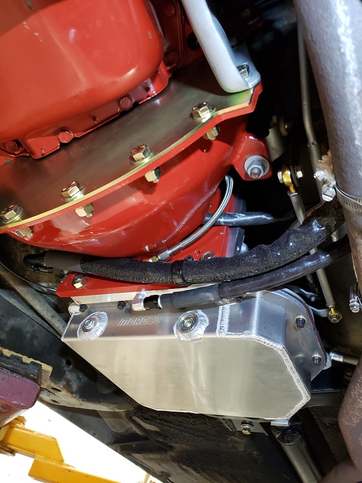

A Clutch Flight?? :D :D
PostPosted: Sat Feb 25, 2023 7:02 pm
Yep...the only 904 Clutchflite around...and the only one behind a Slant Six lol
