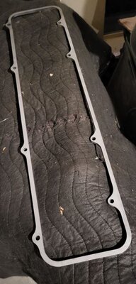

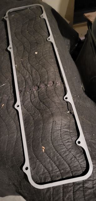

I got the first prototype cut last Saturday out of 3mm cardboard(1/8" in the cardboard world), Anyway, I had an audience of good friends visiting from out of town, so of course, the laser started acting up. For some reason it would start each cut fine, but by the time the beam had traveled 30" or so, it would stop cutting through the material and the beam width had doubled in Kerf. I was able to Exacto knife the uncut areas, hence some ugly edges in the pictures here and there.
I'm figuring the X-axis mirror has come out of alignment, so the farther you travel in X, the worse the problem and cut. It's a 20yr old Beam Dynamics 500W, and usually we can cut up to 1/8" steel, albeit slow, about 4"/min. Anyway, I'll figure it out, since it's my job to fix everything...and I've been fixing this laser for fifteen years.
Here is a couple of pictures. I got all the measurements correct except the end raius'. I thought it looked/measured 1.125" radius, but it must be 1.25 or 1.375" to pull in the corner.
I'll post a revised drawing and CAD files for cutting after I fix the drawing corner radius and the laser, so I can cut another prototype.
Remember, this file would work great as a valve cover rocker clearance spacer, but would need to be modified to work well to make gaskets. When I have a clean valve cover in hand(soon), I'll create that drawing as well.

I bought a couple of valve cover cutouts from Slant Daily.
Shipping was unreasonable, but I wanted the parts and bit the bullet.

The casting might be thicker in those corners as well where the radius sets in around the corner for thicker / wider gasket material/sealing surface.
