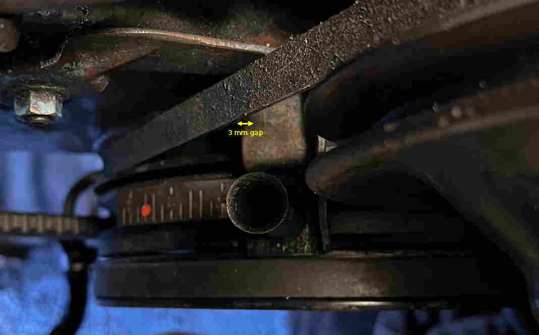

Careful visual inspection revealed only 3 mm of clearance between the timing tab bracket and inner side of the air pump belt:
air pump belt too close to timing tab annotated SL6.jpg [ 24.88 KiB | Viewed 4982 times ]
Removing the air pump belt and fastening it safely out of the way resulted in a wholly normal engine sound: loud noise wholly gone.

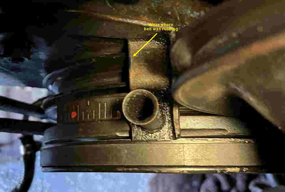

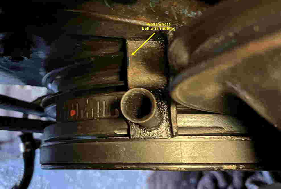

Noticed there has been some wear between that belt and the bracket:
The timing cover had been slightly offset, evidenced by asymmetrical wear on the front and the crankshaft not being centered in the seal before cover removal. I don’t remember what direction it was. When i reinstalled the cover, i was careful to center it, to hopefully minimize leakage.

Experimented with trying to move the idler pulley as far towards the passenger side as possible, to try and get more of a gap between the belt and bracket. Did not really get any more.
What sort of gap is normal between this belt and bracket?
Tried putting the belt back on with what very slight additional clearance i was able to provide. The noise was back. Used the hose and funnel listening technique:
