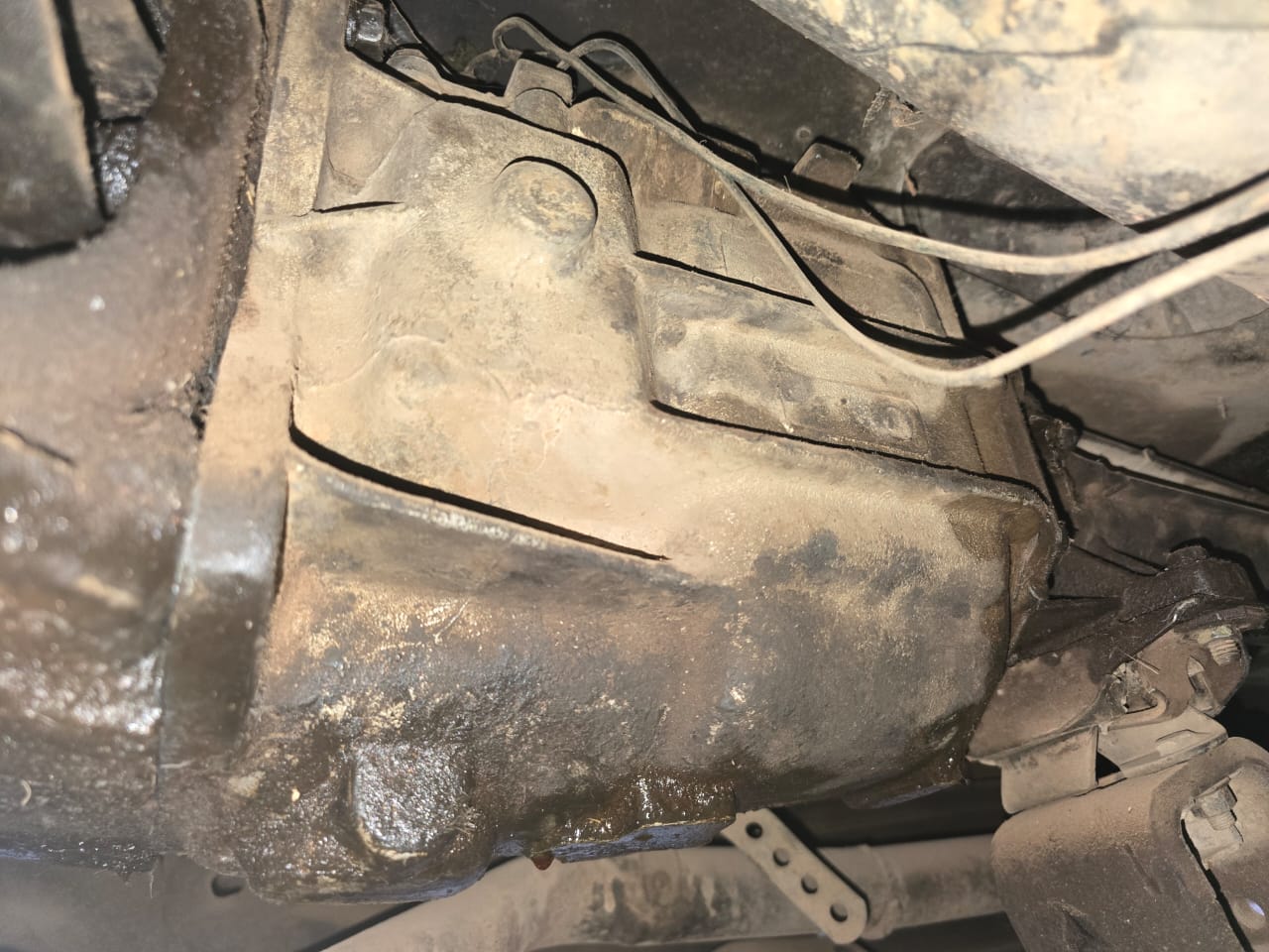

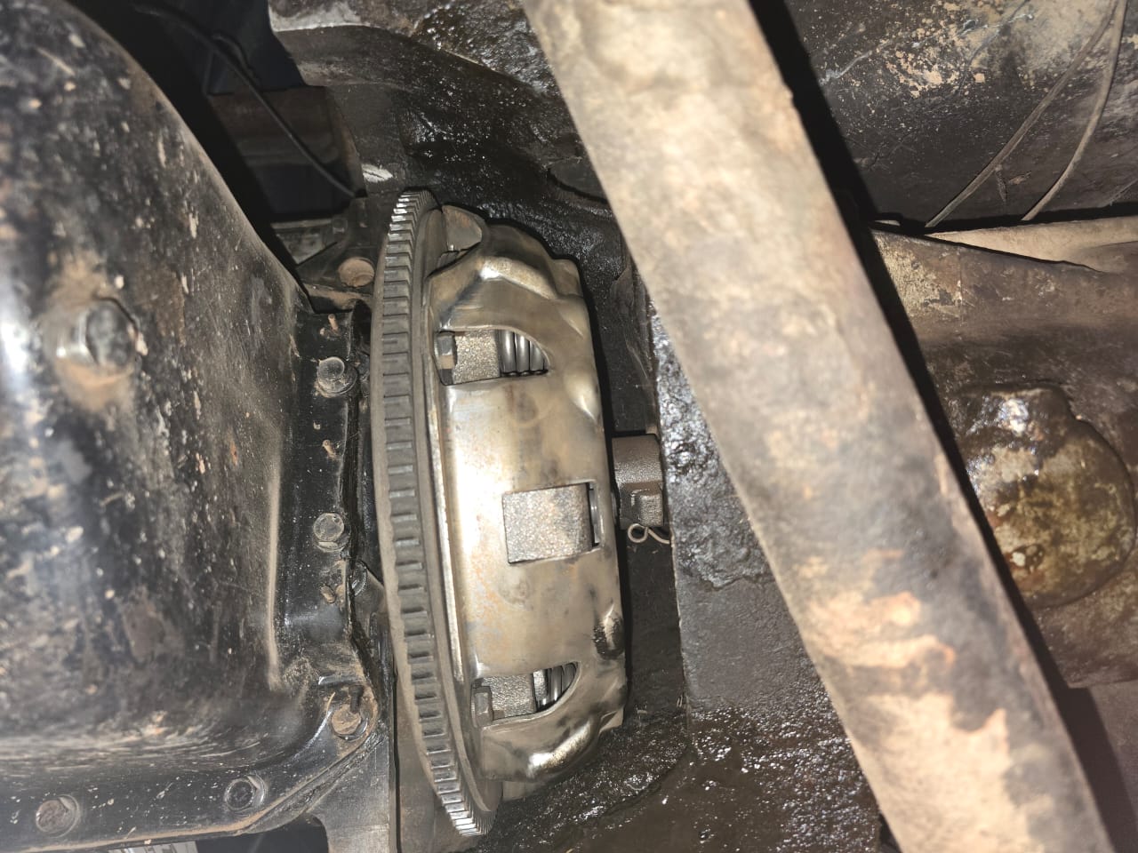

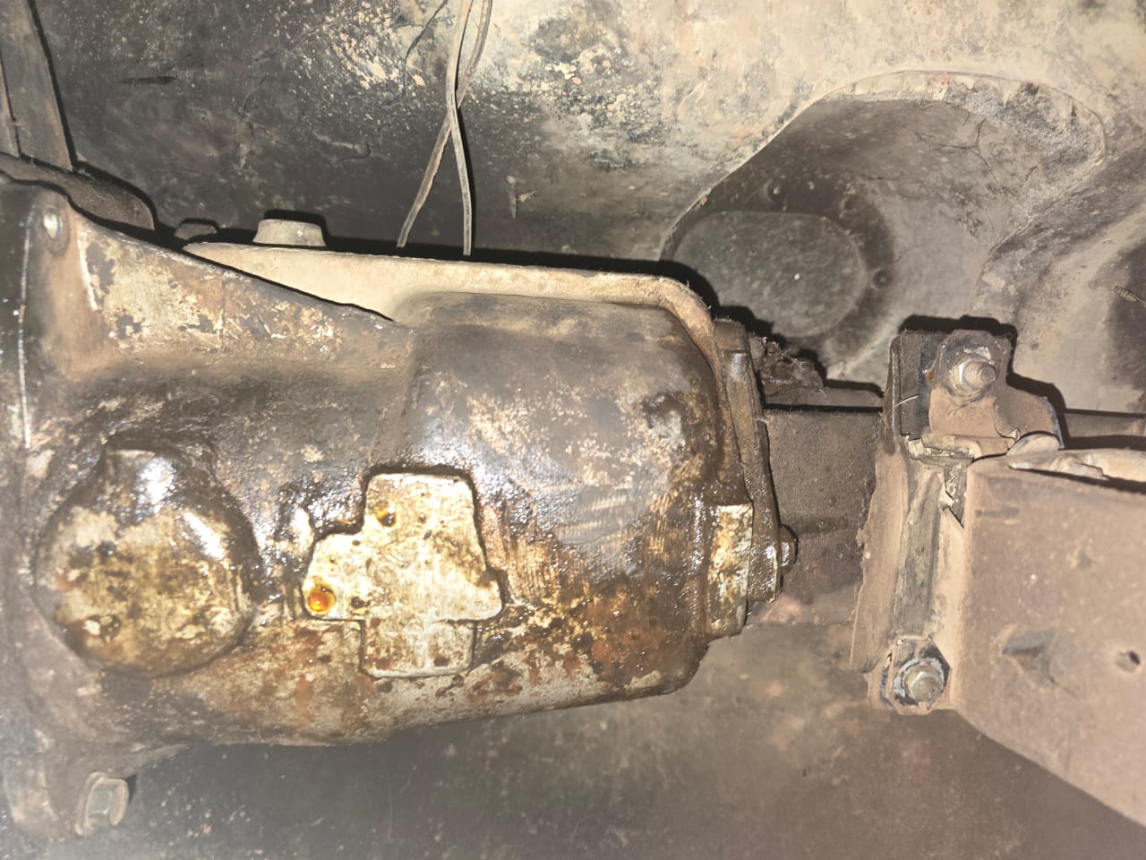

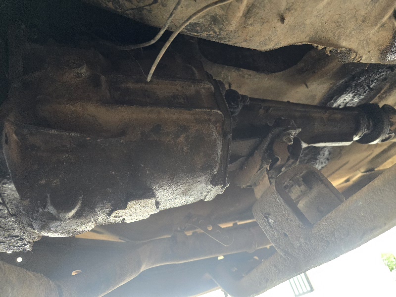

From what I can gather i have a 4 speed t-170 behind my slant six 83. They did a really bad job of doing it and I'm having issues with it. Can anyone guide me and tell me if its worth the hassle of doing it right or changing out the transmission
Number on the transmission is c-2605275

Post detailed pictures or links to high resolution pictures or a video of what you have.

This is all the pictures I have at the moment. The transmission number is c-2605275 i know it's a 4 speed and has a ford clutch.

Turns out the T170 is a Tremec 4 speed transmission used in late 70's to mid 80's Ford trucks and some cars. It is like our 833OD. 4 gears with 4th being overdrive.

It looks like a possible swap job.
The 4-speed hump for the 833 /Hurst shifter is there, s it probably had an 833 at one time.
They did a bad job at the swap

No you would need more than just the transmission if you switch to the granny gear transmission. The Bellhousing, flywheel, clucth, pressure plate are all different, and would need replaced as a set. The shifter on those transmissions is built into the top of the transmission. Your driveline would need a different yoke...etc. Not even sure that the floor pan above the transmission may be different.
You are almost always better to find a complete set up from a donor truck if you are trying to make a swap. Do you want or need the granny gear? I hate them because you basically have a 3 speed with a low gear so low as to be unecessary 99% of the time. Do you want to be able to cruise on the highway and have a OD gear, then the 833 OD is probably the way to go and likely what your truck had originally.

I don't need anything granny gears. And yes cruise on the highway with quick acceleration. How would I know if it's a 833od manual? There is a parts truck that's fully stock slant six with 4 speed. Not sure if it's granny or od guy told me it was a granny. I do know that the shifter is on the top but it's closer to the driver than in the middle

Does the shifter hang off the side of the transmission or does it stick out of the top? 833OD have the shifter mounted onto the side of the tailshaft using an aluminum adapter bracket.
